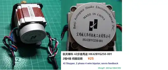

  1. Well, I can have my cake and eat it too, only for ¥25! : )
step motor with feedback

(1) AliExpress HK42BYG250-001 Stepper Motor NEMA17 | High torque 1.2A 38mm stepper motor for 3D printer 42 with speed feedback
