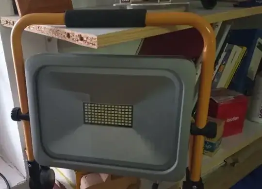

This is a 100 watt LED work light that I use around the house:
The housing is basically one enormous heat sink. It is made of aluminum, with the LEDs solidly attached to the back plate to carry off the waste heat from the LEDs.
Your 70W LEDs will require a large heatsink. Not quite as large as on my 100W light, but not small at all.
