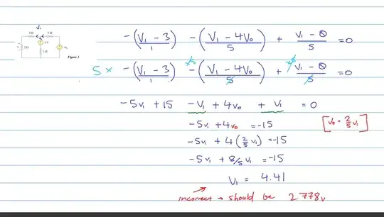

I'm currently doing a question and it appears to me that the direction of the current matters.
For both the batteries I've assigned a current direction that goes from the - to + terminal. So both batteries push the current into node V1 and the only exit is via (V1-0)/5.
However, I keep on getting it wrong. It appears to me that the current direction matters! But everyone online states that is not the case!
Can someone please explain what I'm doing wrong. I'm totally lost.

When we say that the choice of the current direction does not matter it doesn't mean that we apply equations without taking into consideration the chosen directions.
After chosing the current directions we will get values for these currents. If the value is negative it means that the current direction is opposite to the chosen one.
Your error is simply in the first equation. You must consider that the sum of currents entering the nodes is equal to the sum of currents leaving the node.
So in the first equation you just need to change the sign of (V1-0)/5 and you will get the right answer.

  • HI @G36, thanks for a response. But I wanted to know why I didn't get the correct answer. Your current directions at V1 are all exiting whereas my directions are different. I should be getting the same answer as you but I want to know why I'm not because multiple people have stated online that the current direction does not matter as long as it is consistent. – user36278 Apr 10 '21 at 16:14
    because you were not consistent with your current direction assumption – G36 Apr 10 '21 at 16:17
  • Could you please explain to me where I was not consistent? – user36278 Apr 10 '21 at 16:21
  • The first thing that you should do before starting the analysis is to decide for what current direction you will assign the "plus" sign and the "minus" sign.For example,I will give a minus sign if the current entering the node (coming into the node).And the plus sign if the current is leaving the node. In your example, 4Vo current is entering the node thus \$-\frac{4V_O−V_I}{5Ω}\$ do you see it? (4Vo - Vi)/5 means that the current will enter the node. Because the 4Vo is first in the equation implies that the current direction will be from 4Vo -->Vi (from higher potential to a lower potential). – G36 Apr 11 '21 at 08:49
  • The same is true for "3V current" \$−\frac{3V−V_I}{1Ω}\$ .And the last current is leaving the node \$+\frac{V_I}{5Ω}\$ So we have this $$-\frac{4V_O−V_I}{5Ω}−\frac{3V−V_I}{1Ω}+\frac{V_I}{5Ω}=0$$ do you get it? And to avoid making this kind of error in the future it is common to assume that "no matter what " we assume that all the currents will always flow out the node ( leaving the node). Thus, we can give the "unknown node" the higher potential in the circuit and the plus sign $$\frac{V_I}{5\Omega} + \frac{V_I - 4V_O}{5Ω} + \frac{V_I -3V }{1\Omega} = 0$$ This is why Vi is always first. – G36 Apr 11 '21 at 08:49
  • Do you see it now? https://electronics.stackexchange.com/questions/519072/how-to-find-the-nodal-voltage-when-there-is-a-voltage-source-across-two-nodes/519104#519104 – G36 Apr 11 '21 at 08:50

The last +ve sign is the mistake, it should be -ve $$-\bigg(\frac{V_{1}-3}{1}\bigg)-\bigg(\frac{V_{1}-4V_{o}}{5}\bigg){\color{red}+}\bigg(\frac{V_{1}-0}{5}\bigg) = 0$$
Your assumption: -
$$i_{1} + i_{2} {\color{red}-} i_{3} = 0$$ $$-\bigg(\frac{V_{1}-3}{1}\bigg)-\bigg(\frac{V_{1}-4V_{o}}{5}\bigg){\color{red}-}\bigg(\frac{V_{1}-0}{5}\bigg) = 0$$ $$V_{1} = 2.77 V$$
