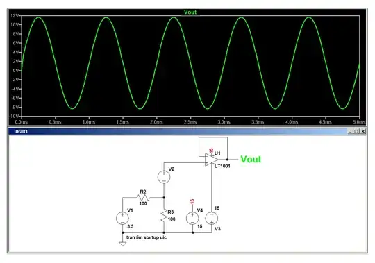

I created a simulation in LTspice representing your situation, adjusting the motor's internal resistance, inductance, and back-emf to get figures close to your measurements. Here's the circuit:-
You say that the battery and wiring got hot, so I added resistors R1 and R2 representing possible battery and wiring resistance. With these values LTspice calculated:-
  • Average battery current: 11.2 A
  • rms battery current: 16.7 A
  • Average motor current: 13.6 A
  • rms motor current: 18 A
  • Average motor voltage: 13.5 V
Here's a plot of the motor current. The motor's inductance has slowed the current rise and fall a little, but not nearly enough to stop it reaching a peak of ~30 A. This high peak current causes extra loss in the resistances in the circuit.
Then I changed the PWM frequency to 3 kHz, and got this:-
Now the peak current is only 16.8 A, the rms current is 11.5 A, and the average current is 11 A. As well as being more efficient, the higher PWM frequency produces average meter readings closer to the rms values that represent the true power losses in the circuit.

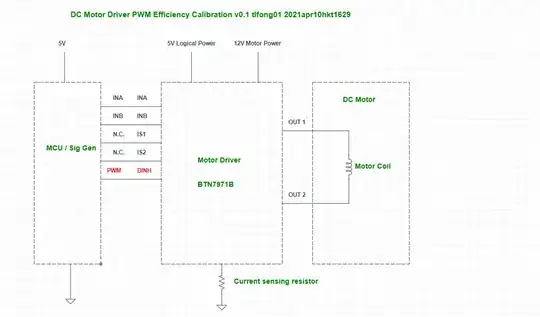

1. I would suggest to wire up a test rig for testing the motor driver with a DC motor, as shown below.
btn7971n test rig
Notes
a. The OP's BTS7971 driver has been replaced by the newer model BTN7971B. They have very similar characteristics and operation. So I have taken the liberty to test the newer driver. I think the OP can compare and contrast the two devices and modify my suggested test accordingly.
2. Now I am going to test the motor driver, measuring the voltage across the motor coil and the current passing through it.
