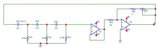

Update
Now it works! Here is my final schematic:
Final schematic

    The phase shift oscillator above uses three RC stages so that there is a way to get 180 degrees out of them, as two wouldn't be able to make it. These RC stages attenuate (reduce) their input signal so that there's only a small bit left on the right side from the input at the left. The goal of this exercise is to find out how much gain the OPAMP must supply in order to make up for the losses in the 3 RC stages. If you are seeing oscillation taking place, then you want to reduce the gain until it stops, then increase the gain until it starts. Find the "sweet spot" where this happens. – jonk Apr 07 '21 at 19:24

What you have is called a phase-shift oscillator. There are many web sites with the design information, in both linear and matrix algebra.
What are V4 and V5? If they are measurement points, fine. But if they are voltage sources, the standard circuit and design methods will not work.
Search for phase shift oscillator schematic. Each of the images has a site attached, so it should be easy to find one with an explanation geared for your level of understanding.

It looks like your intent is to measure the voltage at V4 and V5. But instead of putting a probe there you put voltage sources.
I am not specifically familiar with Micro-Cap but you probably need to put a voltage source on VC and VE so that the op-amps have power.
As for the correct potentiometer value...
  • The op-amps (without the pot) are configured for a constant gain of -1, which is a phase shift of 180 degrees. At the oscillation frequency the phase shift in the network of R1, C1, R2, C2, R3, C3 will be add another 180 degrees to make 360 degrees around the whole loop.
  • You can therefore determine the oscillation frequency by finding the frequency for which the RC network has 180 degrees of phase shift.
  • Once you have found the oscillation frequency you can determine the value of the RC network transfer function (H) at that frequency.
  • The op amp gain (G) is -(RB + RP) / RA.
  • You need the magnitude of the overall gain around the loop to be > 1 in order for the oscillator to work. Put mathematically G * H > 1.
So basically find the transfer function of the RC network. Find the point where the phase shift is 180 degrees. Finally solve for the value of RP that gives G * H = 1, and that is the minimum value of RP.

I'll not comment further on the issue regarding the two sinusoidal voltage sources and the fact that the circuit below uses a single inverting amplifier (the one in your circuit is a non-inverting amplifier and the first is a buffer).
You may need to "jump-start" the simulation with some energy, otherwise it may just react to some "numerical garbage" and settle to 0V in all nodes.
A transient analysis of this circuit:
will not oscillate in LTSpice:
But if C1 is set to an initial condition of 1V:
There probably is a way to do the same with the simulator you are using.
