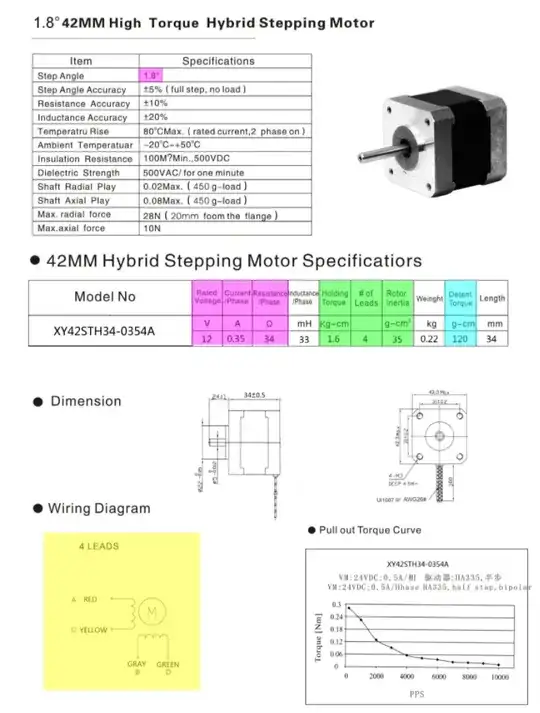

4. Specification of the OP's Stepper Motor
op stepper motor summary
