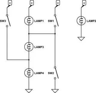

I have the answer to the following problem, but I am not sure how they got it. Please explain:
Four identical incandescent light bulbs L1, L2, L3, L4, and a battery are connected as shown on the diagram on the right. The three switches S1, S2, S3 are open. How will the brightness of the four lamps change compared to the original state if the specified switches are closed (all other switches are open)?
Example: S1 closed.
Expected Answer: L1 - off, L2 - same, L3 - brighter, L4 - brighter.
Answer the following scenario:
(A) S2 closed;
(B) S3 closed;
(C) S1 and S2 closed;
(D) S2 and S3 closed.
The given answer:
A) Answer: L1 - brighter, L2 - same, L3 - off, L4 - off
B) Answer: L1 - off, L2 - same, L3 - off, L4 - brighter
C) Answer: all lamps off (short circuit)
D) Answer: L1 - brighter, L2 - same, L3 - brighter
Thank you so much!

    I recommend grounding the lower-left corner wire and then redrawing the schematic so that it is not so confusing. As you work to unwind it, I believel things will become much much clearer to you and you won't even need us to help out. (In fact, it's what I'd have to do myself before bothering to consider an answer.) – jonk Apr 04 '21 at 21:44

Here's how I'd redraw your schematic:
I think you should be quite able to work out the details for yourself from the above. It's now "easy to read." You really should exercise your skills in redrawing schematics. It will take you very, very far in situations like this one.
For example, it is now very easy to see that closing both \$SW_1\$ and \$SW_2\$ will short out the power supply. You can also easily see that no switches affect \$LAMP_2\$ unless they short out the power supply.
So please, please, please learn to redraw schematics you are given.
See below:
