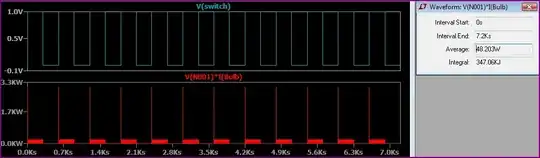

So armed with this info, we can simulate and prove the initial surge would be absolutely insignificant if we switched the bulb every 5 minutes. We don't really need to run the simulation for 2 hours to prove this, but we will. I have even extended the "warm up" time to 300ms.
Here's our SPICE circuit, the bulb is represented by a switch which gradually changes resistance from 9.5Ω to 144Ω over the control signal rise (300ms) The light switch is represented by another switch, which just changes from 1mΩ to 10MΩ
Bulb Test Circuit
Here's the simulation, with the average power shown in the dialog box:

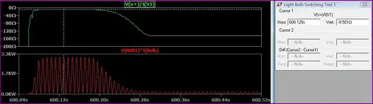

Here is a close up of the switching, with the bulb resistance shown(don't worry about the resistance being negative, that's simply because SPICE calculated it that way using the current flow - it's still a real positive resistance):

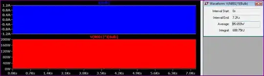

And now, here is a simulation with the bulb switched on for the whole time, with average power shown:
Bulb Test On
You can see that the average power is 95.659W, which is only slightly less than if we doubled the initial 5 minutes on, 5 minutes off test value of 48.2W (48.2" * 2 = 96.4W) so the difference the switching made is tiny.

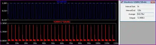

How quick would you need to switch for it to be worse?
It's probably not possible to make it worse as Supercat rightly notes, since the filament will not cool enough between switching. So take the graph underneath as the worst case scenario (e.g. the bulb is blasted with freezing gas between switching or something :-) Note that this would be adding another source of energy to the system though, so would obviously be cheating) Just how fast it cools down and the effect would be interesting to look at though, and if time permits I'll add some more on this.
So, assuming the above, pretty fast, around once every 2 seconds according to the exaggerated simulation above (in reality, probably about once a second) Here's two minutes worth of switching once evry two seconds, and the average power is just over 100W (~104W):
Bulb Test Quick Switch
