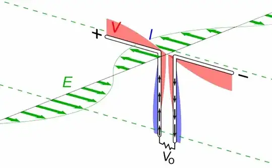

A dipole antenna is two quarter wave monopoles and doesn't require an earth/ground because it is driven differentially and, it is the capacitance from one end to the other that is important: -
Picture from here
