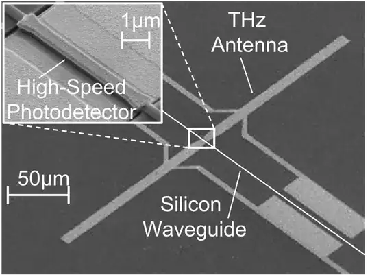

Photonics is a thing, and it very much treats light as electromagnetic waves in waveguides on silicon, with mixers, delay lines, matching circuits, amplifiers etc as you'd do for a RFIC.
Just as an antenna doesn't generate the signal to be transmitted, an oscillator is used to generate a carrier wave – just that the oscillator happens to be a laser diode, sometimes on the same substrate, instead of a discrete transistor, an L and a C. An antenna is just an impedance matcher between transmission line and free-space, and that's what you find on every laser diode die, standard LED die at the point where you try to convert the surface-bound or substrate-travelling lightwave into something emitted into the fiber or a lens or free space.
What you definitely don't find is the classical dipole being fed with a current coming from an oscillator. That doesn't work, as most such components are comparable in size as the antenna. But, there are photonic antennas. These convert a free-space EM wave to a guided wave, just as your phone's antenna converts free-space waves to waves in a coax cable (and vice versa), while simulataneously mixing things with a lightwave. This is not an antenna in the sense of a \$\lambda/4\$-monopole or something.
They are fiddly:
Terahertz antenna THz Antenna coupled to a high-speed silicon plasmonic photodetector enabling opto-electronic generation and detection of waves by photomixing within a THz-bandwidth. Source: Institute of Photonics and Quantum Electronics (IPQ), Karlsruhe Institute of Technology

    This is the correct answer. Optical antennas are within reach of photolithography. Oscillators, amplifiers, and mixers need different technology than we use for longer wavelengths, but that's normal: you can't make millimeter waves with DeForest's triodes either. However, if you'd asked about x-rays... – John Doty Mar 31 '21 at 18:23
  • It's worth noting that the THz antenna you're showing does not produce light in the visible spectrum - it's much longer than that at around 300μm (vs 700nm for the longest visible red), effectively the *far* infrared. Closer to microwaves than to visible light. Nature already provides us with excellent antennas for visible light - atoms. – J... Apr 02 '21 at 08:48
  • @J... exactly! I hoped to make it clear that it's more of a mixer / RF antenna hybrid device than a "light antenna" in the last sentence of my answer. – Marcus Müller Apr 02 '21 at 20:18
