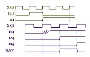

Consider a simple toggle/pulse synchronizer like this: (credits: edn.com) enter image description here enter image description here
For this pulse synchronizer to work correctly, the output signal from flop-A has to be stable for a minimum time period such that there is at least one clock edge at destination clock that will sample the data correctly without metastability. This is because it's possible that the signal causes metastability in the first clock edge at flop-B1. After metastability, flop-B1 may settle to a wrong value, which is then propagated by rest of the flops. However if flop-A output signal remains stable until the next destination-clock edge, it is sure that the correct value is sampled at the second clock edge.
Scenario
Suppose write-clock is very faster than read-clock. Say, you keep write signal asserted high for 2 successive clock cycles (as we discussed at the beginning). What happens is that flop-A output toggles for a single write-clock cycle, and it is never sure that this single-cycle pulse at flop-A is correctly synchronized to the read-clock because of metastability. May be this transition gets completely missed before any sampling clock edge arrives at read-clock. It is also possible that the '1' from flop-A was sampled so close to the read-clock edge and it settled to '0' after metastability. Then the sampled signal remains '0' in remaining read-clock cycles as well, because the flop-A's output signal has already de-asserted after one write-clock cycle. The result is that the you missed the pulse completely. So the write pointer/counter will not be updated at the read-clock domain, and thus the pointers goes out of sync at the two clock domains, and the functionality of the FIFO flaws.
