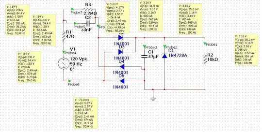

Something like this
alt text
Falstad sim version of it
(I'm tired, I keep making mistakes, so please excuse me for the second time.)
Now these are not very safe PSU's, due to the lack of isolation. But in sealed units, they can be a cheap way of getting the supply voltage for a microcontroller without an SMPS or transformer.
They are not 100% efficient due to the zener and resistors. But, I have several questions.
  1. How does the capacitor step down the voltage, anyway? Does it waste power as heat?
  2. If the zener were gone and the output was let to float around 50V, would it approach 100% efficiency?

This circuit is one of a category of circuits called a "Transformerless AC to DC Powersupply" or a "CR dropper circuit". For other examples, see "Massmind: Transformerless AC to DC Powersupply" or "Massmind: Transformer-less capacitive bleed power conversion" or "ST AN1476: Low-cost power supply for home appliances".
Such a device has a power factor near 0, making it questionable whether it meets EU-mandated power factor laws, such as EN61000-3-2. Even worse, when such a device is plugged into a "square wave" or "modified sine wave" UPS, it has much higher power dissipation (worse efficiency) than when plugged into mains power -- if the person who builds this circuit does not choose safety resistors and zener big enough to handle this additional power, they may overheat and fail. These two drawbacks may be why some engineers consider the "CR dropper" technique "dodgy and dangerous".
How does the capacitor step down the voltage?
There are several ways of explaining this. One way (perhaps not the most intuitive):
One leg of the capacitor is attached (through a safety resistor) to the "hot" mains which oscillates at over 100 VAC. The other leg of the capacitor is connected to something which is always within a few volts of ground. If the input were DC, then the capacitor would completely block any current from flowing through it. But since the input is AC, the capacitor lets a small amount of current flow through it (proportional to its capacitance). Whenever we have a voltage across a component and current flowing through the component, we electronics people can't resist calculating the effective impedance using Ohm's law:
$$Z = \frac{V}{I}$$
(Normally we say R = V/I, but we like to use Z when talking about the impedance of capacitors and inductors. It's tradition, OK?)
If you replace that capacitor with a "equivalent resistor" with a real impedance R equal to the absolute impedance Z of that capacitor, "the same" (RMS AC) current would flow through that resistor as through your original capacitor, and the power supply would work about the same (see ST AN1476 for an example of such a "resistor dropper" power supply).

This power supply only works as designed (provides an arguably constant voltage) by consuming a constant power from AC mains. It is an AC current source, as opposed to a voltage source.
Therefore you need a diode bridge, an energy accumulator (capacitor) and a voltage regulator to transform it into DC.
However, since a constant energy is drawn from AC mains, any energy not consumed by the load has to be dissipated. That is why a Zener diode is used; any excess energy is dissipated in the form of heat in the Zener diode. If it were a linear regulator, input voltage would climb above its maximum Vin to the point where it burns up. And because the amount of power drawn from AC mains depends on AC voltage and frequency (because of the reactance), the Zener diode also helps maintain a constant voltage in the variance of AC mains voltage and/or frequency.
Efficiency:
The power factor is not the efficiency of the power supply and neither is it Vout/Vin. Efficiency is Pout/Pin = (Vout*Iout)(Vin*Iin). In a linear power supply, Iout could be considered to be the same as Iin (if you discard Iq) and therefore efficiency can be simplified as Vout/Vin. In a capacitive power supply however, Pin is constant, so its efficiency will totally depend on how much of the available power the load actually draws.
Power factor (PF):
I've used capacitive power supplies in literally thousands of units, but with different values (470 nF, 220 VAC). Our power supply consumes about 0.9 watt, but about 7.2 VA (Volt-Ampere). It has a very bad power factor, but in a very good way. Since it behaves as a capacitor, it helps correct (bring closer to 1) the bad PF of motors, which behave as inductors and are the main source of bad mains PF. In any case, it is such a low current that it doesn't make much of a difference anyway.
Regarding the components:
47 ohm resistor:
Its purpose is to limit the current through the capacitor and Zener diode when the circuit is first plugged in, because AC mains can be at any angle (voltage) and the capacitor has no charge so it acts as a short circuit.
2.2 Mohm resistor:
Its purpose is to discharge the 33 nF capacitor, because the capacitor voltage can be at any value when you disconnect the mains. otherwise, it would have no path to discharge but someone's fingers (it has happened to me several times).
33 nF capacitor:
As some have correctly stated, they replace a voltage divider resistor by exploiting the fact of their reactance at 50 or 60 Hz mains. You don't get the heat waste of an equivalent resistor, but instead change the angle of the current versus voltage.
Rectifying Diodes (Bridge):
Should be self-explanatory, but they are not necessary; one diode will suffice (in a different least efficient but safer configuration). The thing is for the 33 nF capacitor reactance to work, you need current flowing in one direction and then the exact same current flowing in the opposite direction.
How many diodes are used and in which configuration depends on a lot of things. When using one diode and correctly connecting neutral and phase wires, you circuit GND will be AC neutral, making the output a lot safer, but it has the disadvantage that only on positive half-sinewaves will current be delivered to the 47 µF capacitor.
Using the diode bridge means that half of the time the negative output is neutral, the other half it is mains phase! Of course, this all depends on where in the world you are (literally). Countries or regions that are very dry tend to use phase to phase connections without neutral because of the low conductivity of their earth ground. You can also get two voltage outputs using only two rectifying diodes, zener diodes and 47 µF capacitors.
Zener Diode:
Its purpose is to maintain a (somewhat) constant voltage at the output of the power supply. Any excess current not consumed by the load will flow through it to ground, and thus be transformed to heat.
47 µF capacitor:
It filters out the sinusoidal current delivered by the 33 nF capacitor.
For higher efficiency you need to decrease the 47 ohm resistor to the maximum current the zener will allow when plugged in right at the AC peak and tune the 33 nF capacitor the closest to the exact load current you need.

  • In my simulations, I found the resistor only dissipated a few milliwatts when providing several hundred milliwatts, which is >95% efficiency. The resistor is only there to comply with certain safety rules. – Thomas O Oct 24 '10 at 21:56
    The 2.2M resistor will have small dissipation. The 47 ohm series resistor will be dissipating P=VI[RMS]=(IR)I=.2^2*47~=2W to deliver .2*3.3=.66W. Not super efficient. – Kevin Vermeer Oct 24 '10 at 22:07
  • Sorry, my idiocy drew the wrong schematic. – Thomas O Oct 24 '10 at 22:15
Here is the simulation I am looking at. Don't pay too much attention to the instantaneous readings on the AC side as they are of course fluctuating.
If I adjust the 10k load to a 1k load I am only able to get 782mV out.

    Nothing wrong with using 1N4001s in this circuit- they're only going to see 4V PIV, and even if the load and the zener and the 47uF cap were ALL left off, the diodes would (at worst) just avalanche and dissipate 50mW or so. – Spehro Pefhany Jun 06 '14 at 19:27
Well, it is quite simple actually:
$$X_c= \frac{1}{2\pi f c}$$
That is your capacitor impedance. It changes with 60 or 50 Hz.
Your maximum current will always be:
$$\frac{V_{in}-V_{diode\;drop}-V_{zener}}{X_c//2.2M + 47}$$
And by the way, if you put any load, below the maximum current on the right side of Zener diode, your \$V_{in}\$ current will stay exactly the same... The Zener diode takes care of that.
