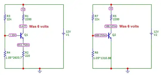

It's both and, it's also temperature and, it's also circuit repeatability. Here's a side by side comparison: -
And, if I increased R4 in the left circuit and R8 in the right circuit by 5% we would see this: -
Can you see that a very small change in the biasing condition hasn't really altered the quiescent DC voltage on the left-hand circuit but, on the right-hand circuit, the collector voltage has dropped from 6 volts to 188 mV. The right-hand circuit is very susceptible to component drift.
If I restore the resistor values and increase the power supply voltage from 12 volts to 13 volts here's what we see: -
In other words, the right-hand circuit is very susceptible to power voltage changes (and also component value changes). If I restore the supply voltage to 12 volts and change the ambient temperature in my simulation from 27°C to 37°C we see this change: -
In other words, the right-hand circuit is very susceptible to power voltage changes, component value changes and ambient temperature changes. But, what if I swapped out the transistor with a 2N3904: -
The above has restored ambient back to 27°C but swapped the BC547s for 2N3904s. The circuit on the left is clearly more robust at dealing with this situation.

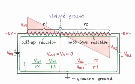

The name of this mechanism is "negative feedback" (more precisely, "current-type negative feedback") and this specific transistor implementation is known as "emitter degeneration". As far as I can remember (not sure), one of the legends says that it ("cathode degeneration") was invented by Otto Schmitt in the 30s. Whoever invented this trick, it is an example of "ingenious simplicity" - only a resistor attached to the existing transistor stage.
Instead of repeating well-known explanations from the web, I will share with you a new insight of mine from yesterday. I had the inspiration to think about the great circuit in the case when Vcc varies.
My observations are that despite the presence of negative feedback, the circuit still responds to Vcc changes (for example, increase) because of two reasons:
1. The bias voltage VRb2 (Vb) increases because the voltage divider Rb1-Rb2 is directly supplied by Vcc (it acts as an input voltage attenuated by the divider and applied to the base). The transistor tries to make its emitter voltage equal to Vb; so the collector current Ic increases, the voltage drop VRc increases, and its complement - the collector voltage Vc, decreases. Figuratively speaking, the transistor "pulls down" the collector output.
2. We can think of Rc as some "battery" that "produces" the voltage VRc = Ic.Rc and it is connected in series to Vcc. So when Vcc increases, it "pulls up" the collector output through the "battery". This is the well-known "voltage shifting" technique widely used in op-amp internal structures.
My conclusion is that the two voltage changes are in opposite directions and can be mutually neutralized.
Indeed, it is not so important for this AC amplifier stage but there may be (DC) applications, in which it would be important. For example, such a "neutralized stage" can be considered as a voltage stabilizer ("Zener diode").
But above all, it is useful as a mental exercise for a deep understanding of the circuit operation.
