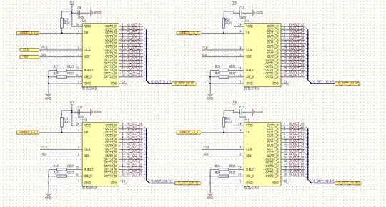

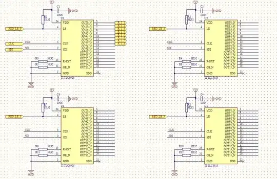

What I am trying to do is connect multiple sheets to the same signals, SDI and CLK. Am I doing something wrong? It is a flat hierarchy, I have set the scope to "Flat (Only ports global)". Below are two sheets of my schematic that uses SDI and CLK signals
Sheet1: http://i.imgur.com/CGcwAeG.jpg
Sheet2: http://i.imgur.com/AllFW51.jpg

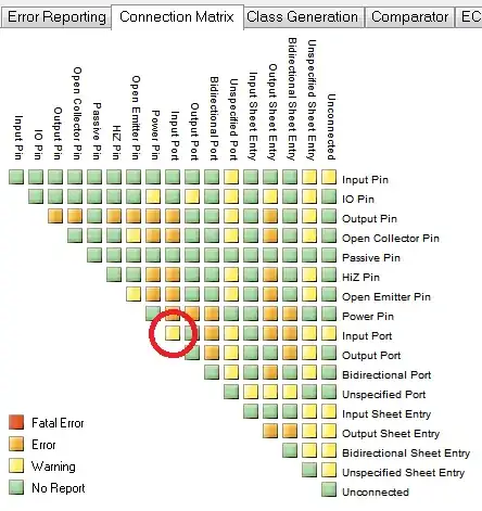

  3. Edit the connection matrix
    Stick with your flat design setting, but tell Altium to shove it by editing the Error/Warning connection matrix:
    Screenshot of Altium Project connection matrix
    Now multiple input ports will only be reported as a warning, not a show-stopping error.

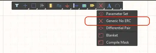

I like the answer by @dext0rb but turning off logical errors/warnings for all ports could cause problems later on.
So just turn off the error on the specific net using "Generic No ERC"
Altium Generic No ERC Location
and then
Altium Generic No ERC Port-Port Connection Option

I prefered to create the ports as Unspecified in this case. While the directional arrows are still held (plus colour coordination) from their previous Input/Output format.
Unspecified allows the user to create multiple inputs and outputs for these ports.

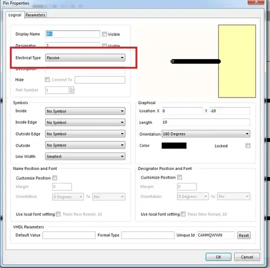

Larry
-1
You just need to change electrical type of pads in schematic symbols to passive.
