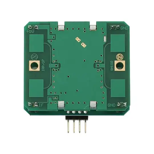

To simplify things, I decided to try an x-band radar module so I can keep the units indoors and avoid weatherproofing. The allure of pointing a microwave device out through a brick wall to detect motion was quite powerful. :-) I'm using this Parallax module (data sheet).
The problem is the unit is picking up movement behind it in addition to anything antenna-side, even with the sensitivity pot set all the way down. Looking at the data sheet (and seeing the graphics representing its field - don't know the terminology), it does seem to be expected behavior. HOWEVER, I want to focus it into a forward-facing beam (relative to the device) so I can aim it outside.

The antenna in question is is called a patch-plane (or plane-patch) antenna -- a patch antenna with a reference plane behind it. You can see it here (the four lighter green squares near the corners).
According to the datasheet, the directivity looks like this:
From behind its detection capability is about 63 times weaker assuming you are on the same level with it. If you are not on the same level, it is more than 250 times weaker.

It's very likely that the rear/side lobes of the antenna itself are not the problem. Any object in the main lobe can also reflect/scatter microwave energy, redirecting it to the area behind the antenna (and back again).
You say that you're sending your microwaves through a brick wall. The dielectric characteristics of brick are very different from those of air (not to mention the wall studs, nails/screws, wires and/or pipes, etc.) and this impedance discontinuity will reflect some of the energy that impinges on it, just like the glass surface of a prism both reflects and refracts light.
