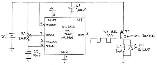

I just happened to have drawn an adjustable brightness LED driver that does use PWM. Maybe overkill, but it does work nicely:
3V is below spec for the NE555, but it does work anyway. Pick a CMOS 555 variant to get around this, or use more than 3V.
The interesting thing about this circuit is that, at least in theory, it is more efficient than driving an LED through a resistor. A resistor converts excess voltage into heat, but by using an inductor you can store energy at one voltage then release it at a different voltage with (in theory) no loss.
Of course this is just a proof of concept, not so carefully engineered, and almost surely far more complicated than necessary, but I thought it would be interesting to share, if only for educational purposes.

  • You don't need the transistor circuitry when it's a normal LED. –  Jan 19 '13 at 16:10
    @CamilStaps He is actually showing how to make a higher efficiency buck for controlling and has a dimmer control. It seems applicable, but not for the user who asked, maybe for many others. – Kortuk Jan 19 '13 at 16:34
  • I know, and it's a good solution. But you can also use the 555 without the transistor, by connecting the LED directly to OUT. Does this, with transistor circuitry on pin 3, use fewer current than when connecting the LED directly to pin 3 of the IC? –  Jan 19 '13 at 16:46
  • @CamilStaps: the transistor is necessary in this application because the 555 output will both sink and source current. If the 555 were connected directly to L1 and D1, then its output would be fighting to drive the inductive load. You could get rid of L1 and instead put a resistor in series with D1, then drive it directly with the 555, but that wasn't the point of this circuit. Or, if the 555 had an open collector output, it could be made to work without an external transistor. – Phil Frost Jan 19 '13 at 18:20
  • No, I see. But with a resistor instead of a transistor + inductor, seems easier to me. But details. –  Jan 19 '13 at 19:34
    @CamilStaps you are right, and it is easier, but that's not the point. A resistor works by converting excess power to heat. An inductor stores it, then releases it into the LED. In theory, this circuit is more efficient. I haven't measured the efficiency of this circuit, so I don't know if it actually is, but the _concept_ is sound, and with proper design, efficiencies can be in excess of 90%. – Phil Frost Jan 19 '13 at 20:36
