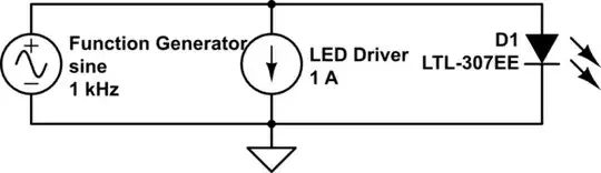

I'm making my question a bit more specific. I was imagining doing something like in the below schematic.
Would a summing amplifier work for this purpose? From the TI schematic, the driver tries to maintain a set current rather than a set voltage (if I've understood it correctly). Would I be safe connecting the circuit up like so?
simulate this circuit
I reread the TI schematic and it seems like the LED Driver is open-drain (please correct me if I'm mistaken). Also, I found out that Op-Amps sort of separate the inputs from the outputs (very little current flows) if there's no connection between the terminals, so it would seem the LED driver would be problematic in the above schematic where it is. My next idea is to add the signal to a 5V supply that would be the main power for the LEDs. What do you guys think?

Your choice of common-cathode red-green-blue LEDs means that an analog LED driver should drive LED current into the open LED anode. The common LED cathode would go to 0V (GND).
But most signal sources provide output relative to ground. This makes driving a cathode-grounded LED with current a bit more complex. Your AD9833 signal source is of this type. Many microphones are too.
Your LED suggests maximum current of 30mA. This means that with no AC signal, it should idle at half-current, at 15mA. Then it can swing down toward zero mA, and up toward 30mA with signal current. The LED would appear constantly bright, because your eye cannot see rapid signal swings at frequencies above 30 Hz. Average current remains at about 15 mA.
An analog driver, driving a cathode-grounded LED might look like the two-transistor circuit (below). Resistor bias is chosen so that most any LED would have roughly 15mA flowing with no input signal, provided the DC supply voltage is +5V. Input voltage to C1 would be about 0.65V peak-to-peak AC signal.
15mA LED driver
