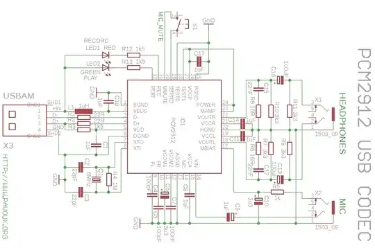

  • This industrial motherboard, as many we had worked with, has an amplified audio output (for 4 to 8 ohms impedances, so you can directly hook an speaker cone). The assembly speaker + connector + unshielded wires to this output was producing that 60MHz peak, somehow. We removed everything leaving that output with High Z (but not disabling it on the mother BIOS) and the peak was gone. I can't identify the amplifier IC per se, its markings are unreadable. So, beware that if using these things.
