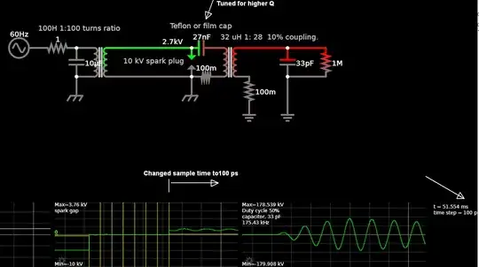

In order to make a great Tesla coil, Tesla did not use any transistors. because they weren't invented yet. (unlike @Andyaka 's)
So how did he maximize dV?
By minimizing dt into a small inductance and reasonably primary high arc voltage to create a low capacitance 2nd stage transformer winding with low turns ratio <100 but a primary step transformer with the highest step up ratio possible so the inductance won't affect the result using the purest 99.9% best insulation, Mica to couple the trigger to the 2ndary transformer and flyback the biggest > 1 MV arcs.
It is hard to simulate with Falstad's limited 2kB trace memory as aliasing occurs when the rise time is faster than 1/2 the sampling rate yet try to fit the repeated arc interval in one trace. But it looks something like this. Slow down the simulation just before it reaches 10.0 kV the trigger threshold of the gas tube I chose to trigger the arc. This will produce > 120 kV. Anything is possible in theory, but practise has physical limits of interwinding capacitance and L/R ratio of a 1kW high inductance primary transformer (huge).
result
V = L dI/dt as dt goes to zero you get the biggest arc voltage but with low L for low open circuit stage 2 secondary capacitance at some resonant frequency. .= LdI/V using an arc gap switch with the smallest dt arc rise time in xxx picoseconds.
HV arcs required a rapid negative resistance to collapse in voltage in picoseconds to nanoseconds to make a UHV flyback coil to generate an ultra-high voltage from the follow-on change in current.
The arc density determines how low the ESR becomes and how quickly the arc extinguishes to determine how fast dI/dt is the result. So by using a gas arc gap, you get far faster rise times than trying to force the current turn-off with transistor capacitance.
It is ultimately the lower capacitance and Q of the RLC resonance of the gas arc extinguishing that results in the hi V. But along with high Q is an envelope rise time so the peak voltage is not always on the 1st cycle but after the risetime of envelope as the primary discharge cap decays with a low negative ESR and the Tesla Coil DCR that affects the result.
Shown with 1ns sampling resolution you can see the rise of the output envelope with a reasonable L/R ratio of 32 uH/0.1 Ohm for Litz wire in a large air core and using a donut termination to reduce e-field gradient.
Now 175kV
Don't try this at home.
