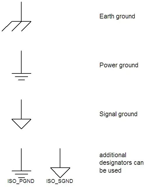

Symbology
These symbols are used in the US (at least).

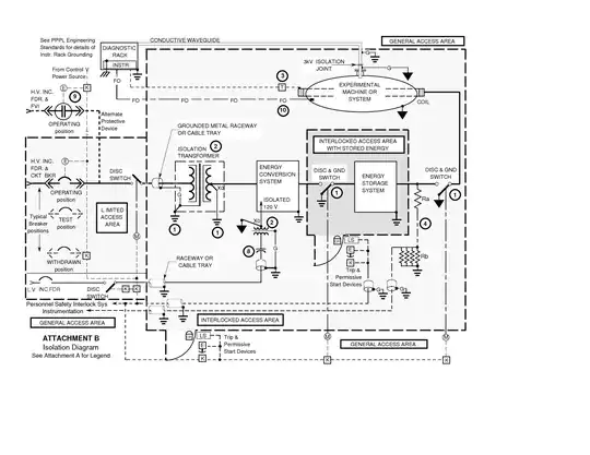

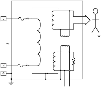

Isolation diagrams
Isolation diagrams are block diagrams, which show the isolation features, such as: transformers, opto-couplers, mains connections, safety capacitors.
Example of a well-detailed isolation diagram
Example of a crude isolation diagram
Nick Alexeev
  • 37,739
  • 230
  • This helps. I always wondered if the two different ground symbols were the same concept or not. I'm glad to see differentiation between circuit ground and earth ground. Would the signal ground be equivalent to a chassis ground? ow what? – dwwilson66 Jan 21 '13 at 17:05
  • You have the "earth ground" and "power ground" symbols mixed up. – Trevor Hickey Jul 10 '16 at 03:55
    @Trevor I don't think that I have mixed them up (although if you provide a reference I'll reconsider). – Nick Alexeev Jul 10 '16 at 06:30
  • @NickAlexeev I was watching this video: https://youtu.be/eGeFVIJ2u0w?t=3m2s If you google image search "earth ground symbol" you will see a consensus on this as well. Even `⏚` = earth ground according to the Unicode Consortium. – Trevor Hickey Jul 10 '16 at 07:14
