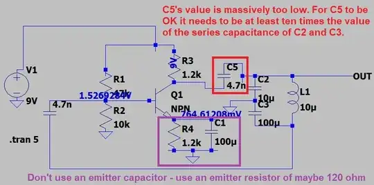

I am desining a colpitts oscillator to oscillate at around 16Khz. I tried to simulate the circuit in LT spice. enter image description here The tank circuit looks right to me but I can't get the circuit to oscillate.Also, the circuit satisfies the berkhausen criterion with $$gain*attenuation = 3.1 (approx)$$.I even tried getting it close to 1 by adjusting the attenutaion but still, it doesn't work. I think it's something to do with the other capacitors like C1 and C5 or maybe L1. My book doesn't go into much detail about these components and it mainly focuses on the barkhausen criterion and how to calculate it. I have much confusion, for example, i can make the tank circuit oscillate by choosing other values of inductor and capacitors but there should be a way so that i don't choose a very high or low value of these components. enter image description here My questions are-
  • What other things are to be considered apart from the tank circuit to make these kinds of oscillators work properly?
  • How to decide which capacitor C1 and C5 to use for the circuit to work properly? if possible please help me with a detailed mathematical explanation.

    c5 looks too small to couple to your big tank caps. Tank cap ratio of 10:1 looks a bit excessive. Please tidy your diagram up so it's legible, then we might be able to see if anything else looks suspect. Oscillators often take a long time to start in simulators. Use .ic initial conditions, or a pulse generator, to give it a kick at startup. – Neil_UK Mar 15 '21 at 08:39
  • @Neil_UK okay what should be the tank cap ratio for a better result. Can you explain a bit more about the .ic condition, i am not much familiar with lt space. – shahrOZe Mar 15 '21 at 09:10
    A 3:1 ratio for the caps seems to work OK with most oscillators of this type. Google for 'initial conditions', it allows you to set a startup voltage on capacitors. An alternative way to get the same effect is to put a voltage source in series with a cap, and program it to output a voltage step after 1us. In real life, noise kicks an oscillator into operation. In simulation, noise is the round-off from floating point calculations, so may take a long time to start, if at all. – Neil_UK Mar 15 '21 at 11:02

If you want a better start with a common-emitter Colpitts design try this answer or this answer. I would also advise you to use a much bigger value of inductance (L1 in your circuit) to obtain oscillation at 16 kHz.

  • @LorenzoMarcantonio I think this comment is better placed under the question. You can make a 16 kHz oscillator from this circuit btw but, your inductance needs to be a lot bigger for it to be effective. – Andy aka Mar 15 '21 at 10:38
  • @andy aka. Can you please explain why i should use an emmiter resistor. – shahrOZe Mar 15 '21 at 17:59
  • @shahrozeshahab did you not read the links I gave - it reduces the gain and helps improve distortion. – Andy aka Mar 15 '21 at 19:09
  • @andy aka yes i have read them and i am still going through it all to better understand. Since i am new to this field I can't understand why using a emitter resistor reduces gain i mean if we use a capacitor then it provides a low reactance path for the ac signal. Why aren't we doing the same here? – shahrOZe Mar 15 '21 at 19:14
  • You have distortion. That distortion is because your transistor circuit has too much gain. Adding emitter resistance reduces the gain of any common emitter circuit @shahrozeshahab it's a general effect of all CE amplifiers. – Andy aka Mar 15 '21 at 19:26
  • @andyaka okay got it. Thanks – shahrOZe Mar 15 '21 at 19:31
