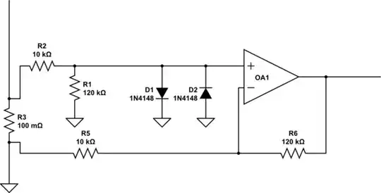

I am working on reverse polarity protection circuit. I found out that most of the people are using the circuit as is mentioned below. enter image description here
I have few concerns regarding the direction of MOSFET
  1. Why is it connected in reverse direction (because if you connect other way also it works)?
  2. The overall current is going through the body diode (because in p-MOSFET current flows from source to drain). How is it helping?

  • "I found out that most of the people are using the circuit as is mentioned below", there is no proof of this claim. Reverse polarity, in what sense? Can you draw an equivalent circuit with a diode, to better understand which is the correct direction/blocking direction. – Marko Buršič Mar 10 '21 at 20:23
    @marko it's for battery reverse polarity protection. Protect the circuit when polarities are interchanged. – niks Mar 10 '21 at 20:34
The P-FET is connected in reverse (drain towards +) so that when the input is backwards, not only is the FET gate OFF, but the body diode is reverse-biased. So that case is covered: reverse current is blocked with the backwards battery.
When the battery connected normally, the gate-drain voltage Vgs turns on the FET and it conducts with a very low Rds(on).
As it happens, the body diode never really comes into play although it doesn't actually hurt anything. This is because when the FET Vgs voltage is ON, the current flows from drain to source (yes, this works - enhancement FETs conduct in either direction). Because Rds(on) is low, not enough voltage develops to forward-bias the body diode above its threshold, so it doesn't conduct.
So the 'backwards' connected FET behaves as a nearly ideal diode, with almost no forward voltage drop. Neat, huh?
Now, what's that Zener for? Because this is a MOSFET, there's a maximum gate-source (Vgs) voltage it can sustain, which is usually +/- 10V for most power FETs. The Zener limits Vgs to a safe level (in this case, 10V) to prevent damaging the device. If the input voltage were only ~10V this would not be an issue, and the gate could be directly connected to GND.
Simulate it here.
hacktastical
  • 49,832
  • 47
  • 138
If you connect it in the "other way" the bulk diode will conduct on a reversal of the supply thus rendering its main usage (a reverse voltage protection) as completely spoiled.
Actually not, because the MOSFET is switched on, the MOSFET channel resistance (milli ohms) is the main conductive path.
  • why body diode will conducts when it's connected in other way around. It won't right, because MOSFET won't even turn ON. Because Vgs=30-0 Which is +ve and mosfet won't turn on and so body diode.(other way around means source will be connected to +ve terminal and drain will be connected to load) – niks Mar 10 '21 at 20:45
  • Not when the input is negative voltage. – Andy aka Mar 10 '21 at 21:29
It is connected in that direction so that it blocks if a negative voltage is applied. The reason for using a MOSFET instead of just a diode is to be able to turn on the MOSFET to short out its body diode, reducing voltage drop and therefore power loss; the MOSFET conducts in both directions when it's on
user28910
  • 3,849
  • when it's connected other way around like source to +ve terminal and drain to load, in that scenario also it won't turn on in reverse direction. Why specially it's connected in other way? – niks Mar 10 '21 at 20:39
  • If source and drain are swapped, the diode will conduct when the supply has reverse polarity, offering no protection. – user28910 Mar 11 '21 at 11:50
What you appear to be unclear on is that the diode shown on your FET symbol really exists. It will conduct in the forward direction whether the FET is on or off, just like a discrete diode would. When you turn off the FET, the diode still exists, so you want it to block the reverse current.
