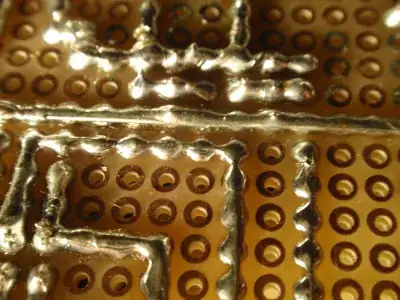

Sometimes I'll need to connect three or four leads. If possible I place these along a horizontal or vertical line of pads and create a solder bridge across the length of them. It's somewhat more difficult than a 2-pad bridge, because the solder will have a tendency to bridge only at the position of the iron, where the heat is. With a little practice, it's entirely possible to create lengthy solder bridges that span several pads. However, it can be ugly, waste solder, and is difficult to change. Multiple bridged pads is something of a hack, so while I do it sometimes, I don't recommend it for best results.
You can improve the bridged pad idea slightly, by adding stripped 24-gauge or smaller wire to the pads and using it to connect them. This image and caption/tutorial from brewpi.com:
...use some naked wire for long tracks and just solder it to the board. For very short connections, you can do it without a piece of wire: Set your soldering iron to a lower temperature, and first put some solder on both pads. Then put some solder on your iron and tip in between the pads. When you are lucky, you’ll connect them. It takes some practice but it is definitely easier at lower temperatures.

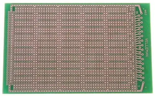

I know this isn't exactly an answer to your question but I thought it might help others. I still use perfboard a lot because it is more commonly available and I have a bunch of it laying around, but since I discovered stripboard, it is my preference. If you workout your layout, you can minimize the number of traces you have to create with soldier or wire. Instead, you use a drillbit to break the strips of copper where you need in order to create your traces.
This is very similar to what JYelton posted at the end of his answer but you can find boards like this all over ebay for dirt cheap.
