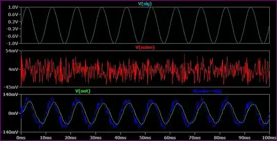

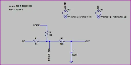

Yes, you can inject noise using the arbitrary voltage (or current) source, then use things like the random or white function to create some noise.
Here is an example circuit (I separated the noise from the signal just to make things clearer - obviously you can combine them together in one function if you wish):
Noise Circuit
Simulation:
Noise Circuit Simulation
All the functions are detailed in the help under circuit elements -> arbitrary behavioral voltage or current sources.

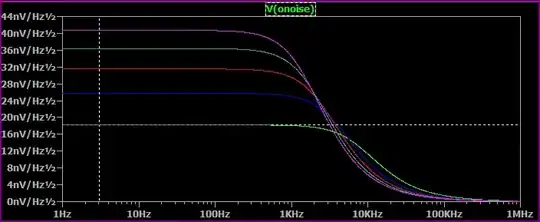

Basic example:
Noise mode
Simulation:
Noise mode sim
The above is rather boring as it only models the resistor noise (I stepped the resistor through various values to show how the Johnson noise increases with resistance). But it can be very useful with more complex circuits containing diodes/transistors/opamps/etc.

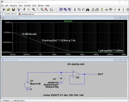

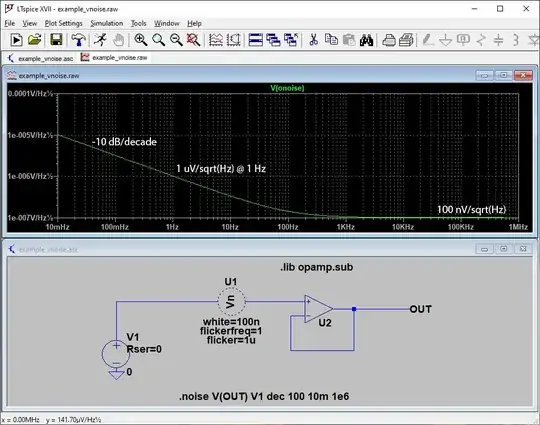

If you are looking for a voltage noise source and/or current noise source for use with LTspice you can download such noise sources on my GitHub page https://github.com/yildi1337/LTspiceNoiseSources.
Below you can find screenshots of two examples:
Example with voltage noise source Example with current noise source
