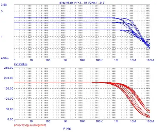

Not really. Plotting the transconductance of the FET (Iout/Vgs) and its phase:
In a common source, you get 2 poles there. Let's choose a positive polarity for the output current (ie, positive when the FET sinks current), that's easier to visualize.
When gate voltage increases and the FET is in control, output current also increases. More Vgs, more sink current, positive transconductance.
But when frequency is high enough that the FET is no longer in control, because its capacitances dominate the opamp's output drive capability, you can replace the FET with a pair of capacitors, Cgs and Cgd. Some of the gate drive signal passes through Cgd and directly into the output, and this creates a current that is of opposite polarity of what the FET drain current would be.
So, when gate voltage goes up, through Cgd output voltage tries to go UP, which means sink current goes down... So, 180° phase shift, two poles.
