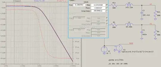

Now for your case, you say that you need a group delay of 259 μs. That means \$\omega_{gd}=10^6/259=3861\$, to which the normalizing \$\sqrt3\$ is applied to get to \$\omega_0=3861\sqrt3=6687.5\$. The terminating resistances are given, so all there is left is to solve for the L and C:
$$H_{LC}(s)=\dfrac{\frac{1}{LC}}{s^2+\left(\frac{1}{R_oC}+\frac{R_i}{L}\right)s+\frac{2}{LC}} \Rightarrow \\ {\left\{ \begin{aligned} \dfrac{1}{R_oC}+\dfrac{R_i}{L}&=\dfrac{\omega_{gd}}{Q_0} \\ \dfrac{2}{LC}&=\omega_{gd}^2 \end{aligned} \right.} \\ {\left\{ \begin{aligned} L_1&=0.24512 \\ C_1&=1.8244\cdot 10^{-7} \\ L_2&=0.065679 \\ C_2&=6.8088\cdot 10^{-7} \end{aligned} \right.}\tag{6} \\ $$
Since it's a quadratic there are two roots, both are real, both give the same results. One with larger inductor and smaller capacitor, and vice-versa. Take your pick. The result is below, where I have slightly offset the traces so they don't completely overlap; the group delays are shown to be the same, and the readings confirm the calculations:
proof
Note: for the Laplace expression (E1) I have used w=1/259u=3861, not the scaled one, as for the calculation of L and C, because the underlying transfer function is already the lowpass prototype, which has the "built-in" correction. For a 55 μs group delay, L=[156.16m, 41.84m], C=[116.23n, 433.8n].

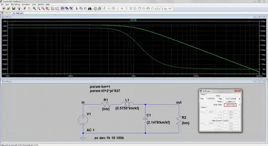

Although the other answer is much more comprehensive (better for school), I though it would be useful to show my lazy-man's way (better for real life) to do an LC ladder Bessel filter in LTspice. First, I'll start with the values from your normalized table, but I'll set up parameters km (for magnitude scaling) and kf (for frequency scaling) for use later. The 2*pi nonsense is there on purpose. Since LTspice typically deals in Hz, it's easier to set up your sweeps if you also see everything in Hz. I'll simulate this and then get the group delay in the passband (see red box) for this normalized filter. One extra thing to note is that I manually right-click on all my inductors and explicitly set the series resistance to zero (it's 1mΩ at default) to make sure these ideal calculations have low error.
Now, I can take the 1.362s and divide it by the desired group delay of 259µs to get the frequency of 5259 rad/s for my kf parameter. I'll convert this to 837Hz (divide 5259 by ) and throw it in my .param statement. I gotta adjust my sweep range first, but then I can simulate this newly scaled filter.
I'll now change km to 600. Even though it doesn't really matter in this example, it's a good sanity check to make sure my equations for the components were entered in correctly. I should get the same exact plot if they were...which I do.
The last thing I do is grab my trusty TI-30XIIS calculator (you can use .meas statements too but I hate them) to evaluate all the component values from the things in braces, and then select real life ones using those calculations. I went with E96 values for the resistor and E12 values for the others. Instead of changing the ideal ones to the new values, I make a copy of the circuit so I can simulate both versions at the same time and compare the deviations. I didn't include the ESR of the inductor in this example, but you can do that for a more accurate simulation.
According to this data, my real circuit (assuming 0% component tolerance) will give a passband group delay of 262µs instead of 259µs.
