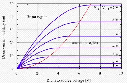

However, when I went to wikipedia I came across the following image:
This is saying the exact opposite of what I understood which is saying that the ohmic region is the linear region.

This is the correct graph: -
Taken from this wiki page.
Saturation refers to the channel being saturated and, as you said, no matter what \$V_{DS}\$ you apply, current remains constant. It is sometimes also referred to as the active region (not to be confused with the MOSFET being activated or ON).
The linear (triode) or ohmic region is when the MOSFET is used as a switch (ON). Your top graph (in the question) is basically wrong because it doesn't correctly show the different slopes in the ohmic region when you apply different gate voltages. This region is called linear because there are different slopes that are governed by the gate voltage and means the MOSFET can act like a variable resistor hence, it gets the name linear but, different texts use this term rather loosely.
