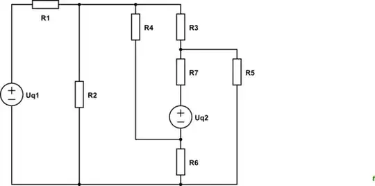

In my electrical engineering lecture we analyse such circuits with given Resistances \$R_i\$ and given \$U_{q1}\$ and \$U_{q2}\$ ( see example below ), and we try to find the current intensity \$I_{i}\$ at each point.
We use a long way to find them using matrices (Elimination using Gauss process, matrice transformation, Kirchhoff laws... (see 2nd picture)) + one error can cost errors everywhere.
  1. The problem is that I can't even check if my answers are correct when doing a exercise. Is there any tool on internet that calculates such things?
  2. Can you recommend any more secure and quicker way to analyse it?
Thank you in advance. Example of a circuitA part of the Procedure (sorry that it's in german)

  • You CAN check yourself by checking power balance. In your case \$\Sigma I^2R=\Sigma UI\$, where U - are your voltage sources. As for the simpler way, this circuit is constructed that way, so to not let you solve it by simplifying the scheme. – AlexVB Feb 25 '21 at 18:10
    Wassim, I'm not familiar with your arrow notation for the voltage sources. There are two different meanings even in Europe, I think. Is the positive end of the voltage source to the tip or the back of the arrow, as you interpret it? – jonk Feb 25 '21 at 18:11
The problem is that I can't even check if my answers are correct when doing a exercise. Is there any tool on internet that calculates such things ?
Yes, any SPICE-like simulator can solve this problem. LTSpice, ngspice, Microcap, and TINA-TI are four free (as in beer) ones that I know of. You can even use Circuitlab (the built in circuit editor attached to this site) to solve this problem.
Can you recommend any more secure and quicker way to analyse it ?
For the general case, no. What they're basically teaching you is how SPICE (and related simulators) solve this kind of problem. In the real world, you'll probably never solve a circuit with more than 3 or 4 resistors by hand --- you'll input it to a simulator and let the computer do all the matrix manipulation. But you should learn how the simulator works so you understand what kinds of problems it can and can't solve, what situations make it more or less accurate, etc.
Figure 1. Circuit redrawn.
I don't know if this helps but it might simplify the analysis - or at least the rat's nest.

    There's a problem with the re-drawing above. Note that the OP's circuit includes a subcircuit that is tied into the node ***between*** \$R_1\$ and \$R_2\$. You have nothing there at all. So it cannot be a correct re-drawing. – jonk Feb 25 '21 at 18:06
  • I even had the reference drawing on a second monitor! How does it look now, @jonk. Thanks! – Transistor Feb 25 '21 at 18:11
  • Well, it at least passes that sniff test, now! Thanks. – jonk Feb 25 '21 at 18:12
  • Thanks, that's very helpful !! – Wassim Jaoui Feb 26 '21 at 10:18
One could use superposition method to solve this one, where the two sources are considered acting alone. Currents of each circuit branch from the two circuits are summed.
It may be helpful to translate Thevenin (V1, R1) to Norton (I1, R1), and translate Thevenin (V2, R7) to Norton (I2, R7).
It may also be helpful to "un-twist" the network as shown below....one is always in danger of confusing current directions with superposition.

In my electrical engineering lecture we analyse such circuits with given Resistances Ri and given Uq1 and Uq2 ( see example below ), and we try to find the current intensity Ii at each point.
By this, I assume that \$I_i\$ is the current in each \$R_i\$. If this must also include direction (likely) then the sign will determine the direction relative to the assumed direction when writing out the equations, I suppose.
  • one error can cost errors everywhere.
Yup. That's a problem and it is why I prefer to use an approach to nodal analysis that I gathered from reading Spice code. It helps avoid such difficulties. More on that, later.
1- The problem is that I can't even check if my answers are correct when doing a exercise. Is there any tool on internet that calculates such things ?
As already pointed out, Spice programs do this as a routine matter. If you haven't already set yourself up with some freely available Spice program, you should immediately do so.
And if you ever want to analyze a circuit symbolically rather than numerically, then you should definitely get sympy and learn to use it. You can readily solve these things using symbolic algebra, if you want.
2- Can you recommend any more secure and quicker way to analyse it ? Thank you in advance.
Yes. And this is when I'd recommend that you learn to re-draw all schematics. Schematics are often drawn for reasons entirely apart from their readability or for simplified analysis. You need to get used to the idea that every single time you see a schematic, your first inclination should be to re-draw it for the purpose you have at hand. The only reason you should avoid it is if the schematic you are looking at is already perfect. (Which it never actually is.) See redrawing addendum below for more information.
Sometimes, it is easier to use mesh and sometimes nodal. You can often decide this by first locating unknown node voltages and name them. Also, all current sources will have an unknown voltage across them, so you'll need to create a new variable for those cases, when present. Then identify appropriate mesh loop currents for analysis, as well. Once all this is done, you can decide which is the less complex approach to take.
If you decide to go with the nodal approach, I'd very much recommend that you arrange your equations so that the outflowing currents are on the left and the inflowing currents are on the right. These must equal each other. When doing this, use the absolute values at each node. Do not attempt to make a decision about voltage differences across a component. Doing so will increase the likelihood that you'll make a mistake with respect to the sign. Using absolute values prevents you from making this kind of mistake. See the KCL Addendum below for further discussion.
For analysis purposes, and assuming a certain meaning for your arrows with respect to the voltage sources, I'd redraw like this:
This can now be quickly turned into the following set of nodal equations:
$$\begin{align*} \begin{array}{c} {\text{Node } U_A:}\vphantom{\frac{U_A}{R_1}}\\\\ {\text{Node } U_B:}\vphantom{\frac{U_A}{R_1}}\\\\ {\text{Node } U_C:}\vphantom{\frac{U_A}{R_1}}\\\\ {\text{Node } U_D:}\vphantom{\frac{U_A}{R_1}}\\\\ {\text{Equiv:}}\vphantom{U_D + U_{q_2}} \end{array} && \overbrace{ \begin{array}{r} \frac{U_A}{R_1} + \frac{U_A}{R_2} + \frac{U_A}{R_3} + \frac{U_A}{R_4}\\\\ \frac{U_B}{R_3} + \frac{U_B}{R_5} + \frac{U_B}{R_7}\\\\ \frac{U_C}{R_4} + \frac{U_C}{R_6}\\\\ \frac{U_D}{R_7} + I_{q_2}\\\\ U_C\vphantom{U_D + U_{q_2}} \end{array} }^{\text{outflowing currents}} & \begin{array}{c} &\quad{=}\vphantom{\frac{U_A}{R_1}}\\\\ &\quad{=}\vphantom{\frac{U_A}{R_1}}\\\\ &\quad{=}\vphantom{\frac{U_A}{R_1}}\\\\ &\quad{=}\vphantom{\frac{U_A}{R_1}}\\\\ &\quad{=}\vphantom{U_D + U_{q_2}} \end{array} & \overbrace{ \begin{array}{l} \frac{-U_{q_1}}{R_1} + \frac{0\:\text{V}}{R_2} + \frac{U_B}{R_3} + \frac{U_C}{R_4}\\\\ \frac{U_A}{R_3} + \frac{0\:\text{V}}{R_5} + \frac{U_D}{R_7}\\\\ \frac{U_A}{R_4} + \frac{0\:\text{V}}{R_6} + I_{q_2}\\\\ \frac{U_B}{R_7}\\\\ U_D + U_{q_2} \end{array} }^{\text{inflowing currents}} \end{align*}$$
Using sympy:
var( 'ua ub uc ud iq2 r1 r2 r3 r4 r5 r6 r7 uq1 uq2' )
eq1 = Eq( ua/r1+ua/r2+ua/r3+ua/r4, -uq1/r1+0/r2+ub/r3+uc/r4 )
eq2 = Eq( ub/r4+ub/r5+ub/r7, ua/r3+0/r5+ud/r7 )
eq3 = Eq( uc/r4+uc/r6, ua/r4+0/r6+iq2 )
eq4 = Eq( ud/r7+iq2, ub/r7 )
eq5 = Eq( uc, ud+uq2 )
ans = solve( [eq1,eq2,eq3,eq4,eq5], [ua,ub,uc,ud,iq2] )
And from there you can generate any and all necessary values.
(If I elected the wrong polarity for your voltage sources, then adjust the above, appropriately.)
Now you have your answer regarding what tools you should acquire and learn to use.
