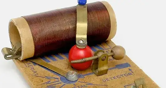

I've been looking at crystal radios recently, and I noticed that many of them had quite big coils (maybe around 5cm on average from what I can see), but wouldn't they want quite a low value inductor to get the right frequency without using an absolutely miniscule capacitor? I know the size would have been quite useful for tapping, but wouldn't they have still wanted them as small as possible?
These are some of the images I found, they are all modern recreations and kits, but ones made to look like the old ones:
Crystal radio with big coil 1

  • The capacitors are tiny (value wise.) Those humongous variable capacitors had values in the picofarad range. That goes together with the relatively low inductance of the large air cored coils. – JRE Feb 24 '21 at 10:08
Note how these inductors are air filled so even though they're physically large in size, that doesn't mean they also have a large inductance.
Indeed tapping off a signal is much easier with large inductors and that is I think the actual reason why they're this large.
With a smaller inductor tapping will be more difficult, the wires are not isolated, if they were, tapping off would be impossible (unless you remove the isolation first). Also the un-isolated wires cannot touch as that would short the inductor.
Also, with a smaller inductor you would get a smaller voltage (at a higher current but that doesn't help) so the output signal would be smaller resulting in a lower volume in the (high impedance, crystal) headphones.
