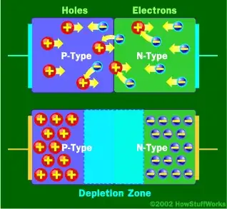

When you bring the P and N type materials together, you form a P-N junction. At the junction, some of the excess electrons cross over and fill the holes in the P-type material, forming a depletion zone (essentially a built in potential):
Depletion zone

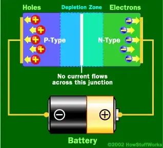

This depletion zone is (almost) non-conductive, as it has no free charge carriers. Now if we apply a potential (voltage) across the junction, depending on the polarity, the depletion zone either widens or narrows. If the region widens, the non-conductive region increases and no current can flow through the diode.
Widening zone

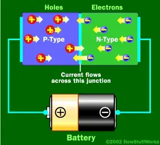

If it narrows, at a certain potential (~0.7V for a silicon diode) the diode will begin to conduct. This (hopefully) explains why the diode acts in the way it does.
Narrowing zone
