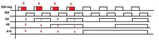

For controlling Enable I would use a clock from 555 with little time delay to let the data to be stabilized after new byte. You can change this delay to less (to about 1us), tune according your 555 frequency. I don't know what clock edge you get a new data from EEPROM, this proposed connection should work for rising edge. enter image description here
  • I have added an AND gate, but it doesn't appear to have made any notable difference. – Rick Dearman Feb 23 '21 at 23:51
  • It is probably because you have to generate E after every 555 clock change (high and low also). –  Feb 24 '21 at 09:41
  • And this circuit generate E only at 555 high pulse. So, from LCD perspective only every second command is received. –  Feb 24 '21 at 09:44
You must probably achieve something like this, shorten the E pulses from both sides:
Since the 74HC107 is negative edge triggered, if you want to use a 555 signal for E you must negate it and cut beginings according to picture. Then you will get a safety time-intervals for command changes.
  • With two 74hc107s i have 4 pulses. So I suppose I should use the the first Q1 for E, then the remaining for a8-a10. But if I understand you are saying I need an inverter in order to make sure the data is set before the E is triggered? – Rick Dearman Feb 27 '21 at 01:08
  • My idea was to use 3xJK, feed the first one with 555 and the outputs from JKs connect to A8-A10. Then also take the 555 signal, invert it and short this pulse with the AND and RC I posted before. This signal connect to E. –  Feb 27 '21 at 01:30
