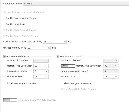

Appendix :slight_smile: This my AXI DMA setup
