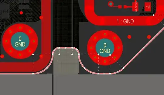

I am trying to add a "via shield" to my PCB edges, which is also called a Faraday cage.
I am trying to add vias using Altium software, but the vias are added outside the PCB edge and not inside.
Any idea how to add vias inside the PCB edge?
Above are the settings that I used for via stitching. Can anyone tell me what settings I need to use, to add the shielding vias inside the PCB edge?

To achieve what you want using the via shielding tool:
  1. Lay a track around the outer perimeter of your pcb but offset from the edge, assign it to the GND net. (You may need to uncheck "auto remove loops" in your PCB settings)
  2. Select the track you just laid (select a segment and hit tab to select entire track).
  3. Open the Via Shielding tool and select GND for your net, and check the box for "Selected Objects"; this will limit the shielding to be on either side of your track.
  4. Configure the via sizing and spacing as desired and click ok to apply. You should have vias now on both sides of your track, with net GND.
  5. Select and delete the track. The vias will remain in place. You can delete the inner row of vias if you desire only a single "fence".

I tried @gcr method. It works very good! Here is how I did with screenshots:
1 - Copy/paste board outline track on top layer
2 - Shelve all polygons (t + g + h)
3 - Assign the copied tracks on GND signal enter image description here
4 - Add shielding vias to GND enter image description here enter image description here 5 - CTRL+H to select the GND track around you PCB and delete it
6 - Restore all polygons (t + g + e) and repour all (t + g + a) enter image description here
Here is the result: enter image description here
