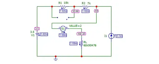

Redraw the picture with what you know about the problem and the apparent "solution": -
  • The resistor values R1 and R2
  • The 3.3 mA current source
  • The 3.5 volts voltage source
  • The "correct" current through RL of 1.68 mA
Then, because you know the current must split and add up to 3.3 mA, the current through resistors R1 and R2 must be 1.62 mA: -
This then means that the voltage at the top of the current source has to be: -
3.5 volts + (18 kΩ + 7 kΩ)•1.62 mA = 44.000 volts: -
You also know the voltage across R1 (aka VA) = 1.62 mA • 18000 = 29.16 volts
And, 2•VA = 58.32 volts hence, the voltage across resistor RL must be 44 volts + 58.32 volts = 102.32 volts: -
This cannot mean anything else other than that the resistor RL must have a value of: -
102.32 volts ÷ 1.68 mA = 60904.76 Ω.
And, if that doesn't convince you, here's the result of a simulation: -
Should I change RL to (say 50 kΩ) we get a different current distribution and the wrong answer: -
A note about maximum power transfer (following comments). If the "real" question sought to find the current in RL when the maximum power was transferred to RL then RL would equal 61 kΩ. This is because the presence of the VCVS (with a gain of 2) would make an equivalent impedance of twice R1. Given that finding the Thevenin equivalent impedance means we can ignore the current source, the total Thevenin impedance is R1 + R2 +2•R1 = 61 kΩ. And when RL equals that value, we have maximum power transfer and I(RL) would be 1.67869 mA.
