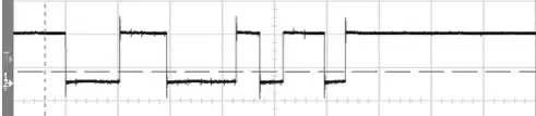

Serial protocols
Except for Manchester coding data and clock are separate on most protocols. Want to analyze your data with only the data channel? Like this:
Well, good luck! This is the SDA channel of an I2C bus. Any idea of what it represents? Not without the clock:
Now you not only can see what SDA is on each clock pulse, you can also see the I2C start condition: SDA going low while the clock is high. Impossible on a single-channel scope.
