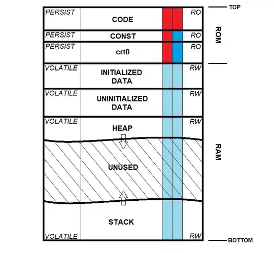

Below, I've borrowed and modified an image I drew up years ago for another purpose:
There are two colored columns. The left-side one is for von Neumann and the right-side one is for Harvard. For the basic von Neumann architecture, all three sections, CODE, CONST, and crt0, can be placed into a single ROM (flash.) As Harvard architectures have a separate memory system for code and data, there are two such ROMs required unless there are special instructions added in order to access the code memory system as data. The lighter blue is the same for both: SRAM/DRAM.
In the above diagram, I've used ROM loosely. In systems with core memory, for example, it's actually persistent RAM. Some decades ago, MCUs frequently used OTP (one-time programmable) memory and it was truly ROM. Today's systems usually use flash and in many cases it can be written to many, many times. In some cases, where the flash is broken up into multiple sections, writing is possible even while the program is running. (Though not well enough for many purposes.)
The key idea here is that ROM as I intend it above stands for non-volatile memory that may be, but does not need to be, writable. (It obviously does have to be readable, though.) There are no other requirements.
Likewise, the key idea here is that RAM as I intend it above stands for memory that must be writable. It may be volatile, but doesn't need to be.
This is what all of the tools, the compilers, assemblers, and linkers have as their basic concept. There are missing details. Compilers generate code and the code is placed into code segments that the linker collects together in certain ways. I've left out such abstracts as code and data segmentation (this is what the linker processes) and details about how that works. What you see above is just what finally results after all the segments have been organized and placed by the linker.
I've used the word persist where I meant non-volatile memory. These sections must power-up with the right values and must be in some kind of persistent memory system(s). The sections listed as volatile can be taken as if they are SRAM or at least some kind of work-alike as with DRAM. They could also be FRAM (which is non-volatile.) But the main point is that they are fast memory and writable. (You need fast memory for stacks and heaps and variables.)
Program Model Comments
You almost never see all of the code in a program you write. This is particularly true with C and languages other than assembly code. This is because there is a start-up process required. In C compilers, this is usually hidden inside something just called "crt0." (C, run-time, code section 0.) That's the piece that makes sure your stack is set up, the heap space is properly initialized, and that any necessary initial values have been taken care of for your initialized static lifetime variables.
In some languages, such as C, even the uninitialized static lifetime variables have defined initial values (int is 0, float is 0.0, etc.) However, not all languages have that requirement. So a linker cannot assume that this is always the case. If you are mixing languages as well as assembly, then there can be uninitialized static lifetime variables that do NOT require initialization. And so there's no need to waste precious CPU cycles initializing them.
This fact is why I also included an uninitialized data section. C does not use it. But other languages do. So you cannot assume that it is not present. It may be or it may not be. It all depends. But the model above is very general and will apply to almost any "standard" program model. (Obviously, much more complex arrangements can be and have been designed. But this is the primary one to learn about.)
Section Descriptions
--CODE--
Looking back to the diagram above, there is a CODE section. On power-up, this must be valid and workable, immediately. That means it must be in non-volatile memory. (This section includes the crt0 code that is placed to that it starts up when the MCU powers up.)
On some machines, CODE may reside behind a protection barrier so that it cannot be read or written, but only executed. (The modern x86 is an example.) On other machines, it's readable but cannot be written into.
But in the strict sense, the only requirement is that it may be addressed and executed. There is no necessary requirement that it can be read or written. (That doesn't mean that a relaxed system may allow reading or writing code. Many do. It's just that the only necessary and sufficient requirement is that it can be executed.)
For MCUs today, this is usually implemented with flash memory.
--CONST--
There is also a CONST (constant data) section. This section must also be in non-volatile memory.
Strictly speaking, this includes all constant values needed by a program. Examples would be error message strings and the value of \$\pi\$. You don't ever need to write to these values, directly. (Though you may copy them somewhere and modify them.)
--crt0--
This section includes all of the necessary values used to initialize the static lifetime variables stored in volatile memory (SRAM, for example), whether or not they are writable, before the program starts executing. (That initialization is handled, for example, by the hidden crt0 code for the C language.) This section must also be in non-volatile memory.
For MCUs today, this section is usually implemented with flash memory.

--INITIALIZED DATA--
This is where all of the initialized writable static lifetime variables go. Their initialized values either come from the crt0 section or else must be defined by the language. (In c, a semantic 'zero' is usually applied when the initializer is missing from the static lifetime variable definition.)
Every time the program is re-started, these variables must be re-initialized by crt0 code.
For MCUs today, this is usually implemented with SRAM memory.
--UNINITIALIZED DATA--
Some languages (not C) allow static lifetime variable definitions which truly specify no initialized value for the variable. Assembly code is a classic case for this. But it's not the only case.
For those languages, there is no need for crt0 to do anything. (And I'm still using C's crt0 as a metaphor for other languages which may call it something else.) The values will be set up by the program sometime after it starts running, so there's no need.
Since these variables are, by definition, uninitialized its a given that they will be written into. So they must be writable.
--HEAP--
This is usually set up right at the very end of the static parts of the program (the above listed sections.) Those all have link-time known sizes and therefore are known before the program starts running.
Heap is usually allocated "upwards" in memory, towards the stack. It is always writable (necessary) and is therefore typically in SRAM.
--STACK--
This is usually set up right at the very end of the memory system's SRAM addressing. It allocates (usually) in a "downwards" direction, towards the heap. It is also always writable (necessary) and is therefore typically in SRAM.
By setting up the heap and the stack to work towards each other, a benefit is that the total memory footprint is known at the time the program starts (operating systems love this, but it's also a necessity for memory-limited MCUs, too.) Another is that although the required stack and heap are of unknown size before the program starts up, they at least are arranged to minimize a conflict later on. (Of course, for stand alone instrumentation code you really do NOT want any conflict ever.)

All variables that are not constants live in SRAM. The variables that are uninitialized are actually initialized to zero by startup code when your program starts, and the variables that are initialized to some value, are initialized by copying their data from Flash to SRAM by the startup code.
Justme
  • 127,425
  • 261
  • The initialization of variables in RAM is language specific. What you describe is certainly true for C but I wouldn't say that this is always the case. – Elliot Alderson Feb 03 '21 at 20:10
  • Yes, this answer was in the context of C language because the question was also in the context of C language. Other languages may work differently. – Justme Feb 03 '21 at 21:00
