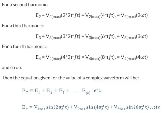

The problem with AC harmonics is that each term has a different frequency, being a integer factor of the first frequency. I was wondering if there was a way to conveniently express equations in AC harmonics in terms of phasors without any confusion. By that I mean, some additional detail would be added to indicate the frequency of each phasor so that it would be clear that they cannot be added together directly.

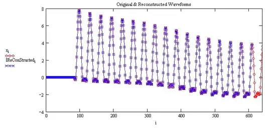

That is what I am doing in this example where I calculate the harmonic content of a transformer inrush current. I actually re-constructed the original waveform from the phasor data at the end (as a check).
Here was the inrush waveform (about 18 cycles worth at 60Hz): enter image description here
I did a sliding DFT across it so that at each sample point I computed the phasors for harmonics from fundamental up to Nyquist. Then, to make sure my approach was correct I took those phasors, and at each point, reconstructed the original waveform (below):
Remember that with my approach I am calculating a set of N/2 phasors (N was my sample rate) at each sample point along the waveform - a sliding window for the dft.
