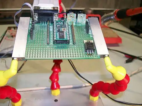

I had one just like the one you linked to, and I would recommend against it. I remember the joints not holding very well, slipping around, flopping, etc. and the base being too small to counterweight pretty much anything.
There are some cool projects on Intructables made of coolant hose or wire that look more promising. You can build actual PCB holders with slots, scope probe holders, etc:
helping hand made of coolant hose PCB holder
(I wouldn't be surprised if someone is selling these in small quantities somewhere, too.)
