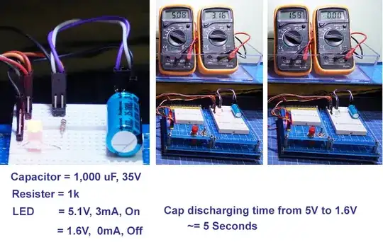

I found the testing of LED input voltage vs current and brightness a bit tedious, besides not very reliable. So I assembled a simple test rig for quick and dirty testing, as shown below.
led test rig
Now I can test one combination of capacitance, V, I, brightness in less than 2 minutes. A very rough summary is given below:
  1. For cap at 5V, the diode current with 1k series resistor is roughly 3 ~ 3.5V for Red, Yellow, Green, but lower voltage for Blue and White. RGY lasts longer, BW dies fast. Red is the most efficient.
  2. For 10,000, 1,000, 470, 100uF, as expected big caps store more energy, so the LEDS grow loner. Very roughly, for 10,000, 1000, 470, 100uF, the light up time is very roughly tens of seconds, a couple of seconds (10, 5, 3) I surprisinglyly found that, even of the OP's cap value of 100uF, all my different types of LED can last 3 seconds. So I think the OP is not using super bright LEDs, or his caps are poor quality.
  3. One very surprising thing is that I found the 1W RGB 350mA power LEDs, do not different from the ordinary low power LEDs, when testing condition is around 3mA. So I think 1W 350 mA RGBYW LEDs are very flexible, can be used as orginary LED at low current < 20mA, and can scale up to high power with up to 350mA.
One very important conclusion I jumped to is the following. Since LED current varies drastically as even small change in voltage, it is difficult to control current and brightness (which is linear to current) by adjust voltage.
So now I appreciate very much why CCS (Constant Current Source) is used in almost all of non hobbyist application and projects. So I am stalling my testing at this point, because I am diverting to learning and playing with CCS stuff, and only come back after I have build up confidence in CCS skills.
