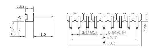

Based on the source for the KiCad 3d model generator, these pin headers were modeled using a WE 613 0xx 110 21
You can find them in stock at Digikey
WE Header
Actual part
