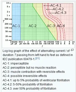

An electrical danger chart from wikipedia:
It's for AC current and on the vertical is the time you're exposed and the horizontal is amount of current so we can look and see that 50mA for a second or more may stop the heart, and any current above that exceeds what is necessary to kill. 120 volts is enough voltage with the average person in average clothing. What exactly constitutes a "Low impedance ground path" is affected by the source voltage, impedance and current limit. In the case of 120v or 240v residential lines, a line protected by a 50A circuit breaker requires a larger grounding/bonding wire than one protected by a 15A circuit breaker because for the breaker to trip, a fault at the same voltage must cause more than 3 times as much current to flow. The faster the surge, and the faster the breaker trips, the shorter the surge is. You may have noted that "low impedance path to ground" is quoted, not "low resistance". The ground network must not just be low enough resistance to allow a high current flow and trip the breaker, it must also be low inductance to prevent delay in tripping due to inductive effects.
