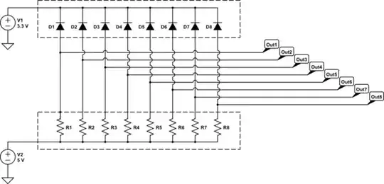

Would I need to make one of these circuits for each of the pins or could I, for example, replicate the bottom row again and increase the value of the resistor?
If you want to level shift many signals, you may find an integrated circuit such as the SN74LV1T34 useful.
However, if you want to use diodes and resistors to translate signals from 3.3V to 5V, using circuits such as you provided, then unfortunately you need to replicate that circuit for each signal you wish to translate from 3.3V to 5V. However, it is possible to purchase items such as diode and resistor arrays which may make life easier. For example:
