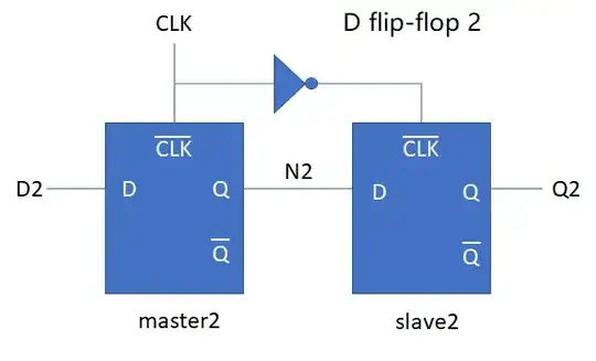

I am trying to create D flip-flops with D latches. Below are 2 possible ones. (Note that they are both rising-edge triggered.)
I tried to analyze their behaviors at the clock edges.
For D flip-flop 1,
  • At the rising edge, because the clock needs to go through one more NOT gate to reach the master1 latch, so I think the master1 latch will become opaque a little bit later than slave1 become transparent. That is, both D latches can be transparent at the clock "rise" for a short moment. As long as the D1 remain stable around the rising edge, the D will propagate all the way to Q1 as soon as slave1 becomes transparent.
  • At the falling edge, for the same reason, master1 latch will become transparent a little bit later than slave1 latch becomes opaque. Q1 will be held by slave1. So D1 won't affect Q1.
For D flip-flop 2,
  • At the rising edge, master2 becomes opaque a little bit earlier than slave2 becomes transparent due to the NOT gate. This is still OK for N2 to propagate to Q2 once slave2 becomes transparent.
  • But at the falling edge, master2 becomes transparent a little bit earlier than slave2 becomes opaque because the CLK signal reaches master2 sooner than slave2. So it's possible that master2 turns transparent while slave2 also remains transparent. That is, both D latches can be transparent at the clock "fall" for a short moment. Thus Q2 may be contaminated by D2, which is not OK because slave2 fails to hold the Q2.
So the D flip-flop design 2 is bad.
Is my analysis correct? It seems the critical part is for the slave D latch to respond to the clock faster than the master D latch.. But I don't know yet how to quantify/specify this constraint. Most timing analysis I glanced so far focus on the rising edge. But I think the falling edge is also relevant.

    It all depends on the setup, hold, and propagation times of the latches. You should be able to create some formulas. For the fun part, grab some real-world data sheets and apply the values. – the busybee Jan 22 '21 at 11:08
  • Recheck your analysis. Case 1 has overlap (both latches open) at clock rise, Case 2 does not (first stage closes before second stage opens.) – hacktastical Jan 27 '21 at 21:02
  • In the second case, Stage 1 has positive (helpful) skew that is in a race with the inverter, delaying the Stage 1 transition after the clock. This prevents shooting through. – hacktastical Jan 28 '21 at 06:56
  • The Stage 1 delay is at least 2 inverters when it’s open. The clock skew inserted by the inverter is only 1. So the clock wins the race, ensuring Stage 2 is closed before Stage 1 can propagate to it. – hacktastical Jan 28 '21 at 07:17
  • The skew inserted by the inverter is in the wrong direction. It neutralizes the beneficial delay of Stage 1. – hacktastical Jan 28 '21 at 07:29
  • @hacktastical Both cases have short moment that both D latches are transparent. Case 1 at clock rise and case 2 at clock fall. I updated my post to add that. – smwikipedia Feb 28 '21 at 03:39

  • The timing constraints for the first circuit to work are: \$t_{ccq(initiator)} + t_{cd(inverter)} >= t_{hold(follower)}\$
  • The timing constraints for the second circuit to work are:
    \$t_{ccq(initiator)} >= t_{cd(inverter)} + t_{hold(follower)}\$

  2. D Flip-Flop using latch with negative enable D Flip-Flop using negative enable
    Simulate this circuit on Multisim Live: D Flip-Flop using latch with negative enable

  • I think you changed the rules between your two circuits. One of them has the clock source connected directly to one of the latches, the other one requires two inverters between the clock source and a latch. – Elliot Alderson Jan 28 '21 at 14:58

Case 1 has an increased hold time requirement, since both Stage 1 and Stage 2 have an overlap in their 'open' time due to the inverter delay. This overlap needs to be added to the hold time spec to ensure reliable operation.
That is,
  • At clock low, Stage 1 is open, Stage 2 is closed
  • At clock rise, Stage 2 opens. Stage 1 is still open => D could still change Q state (this is the overlap time)
  • After inverter delay, Stage 1 closes.
Case 2 is a more typical design. Stage 2 is either clocked at the same time, or after Stage 1.
  • At clock low, Stage 1 is open, Stage 2 is closed.
  • At clock rise, Stage 1 closes => D has no effect
  • After inverter delay, Stage 2 opens
Because of the inverter delay, there is no overlap of the open-time of the two latches. This means setup/hold is only determined by Stage 1. Stage 2 has its hold time met not only due to the inverter delay, but also due to the propagation delay of Stage 1 (more about this below.) This configuration however does have a longer clock-to-output delay than Case 1 due to the inverter delay.

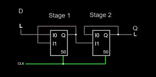

There's a different way to think about latches: as a special case of multiplexers. The latch is in one of two states:
  • Follow input (transparent)
  • Hold
This can be constructed by using a 2-to-1 multiplexer, with one input tied to the data input, and the other tied to data output. Below is a D clocked-flop design, using multiplexers wired as hold/follow latches:
Simulate it here: D flip-flop using muxes
How it works:
  • Stage 1 follows during clock low, and holds during clock high.
  • Stage 2 follows during clock high, and holds during clock low
Notice that there's no inverter (more about that in a bit.) Stage 2 and Stage 1 switch from hold to follow and vice-versa at the same time. The propagation delay from Stage 1 select to Q ensures the hold time for Stage 2, such that there is no overlap. Again, only Stage 1 needs to be considered for setup time.

If the inverter on the clock net is implemented with an actual inverter, i.e. introduces a measurable delay, then your analysis is spot on: design1 is stable because slave2 has time to latch before slave1 has time to change, whereas design2 is marginal because it has a race condition on falling clock because master2 changes at about the same time as slave2 unlatches.
If the clock and inverted clock were generated simultaneously, say from Q and Q_NOT outputs of a flip flop, then there would be no delay between clocks and both designs should work equally well (although you are now depending on the latch-on and latch-off times to be closely matched).
Creating flip flops from latches seems like a dubious exercise and I hope this is being asked only out of academic interest. In real life you’d be much better off implementing flip flops with flip flops.
