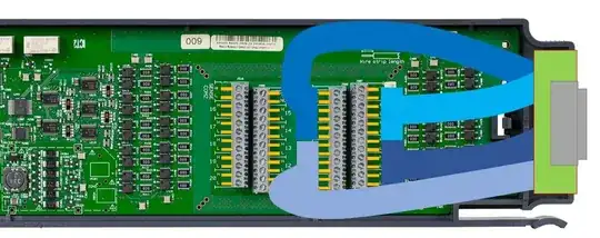

So far, I've decided to remove the strain relief slots, drill mounting holes at the entry for a D-Sub PCB connector (for strain relief), and run flex ribbons from the PCB to all 4 screw terminal blocks (see image with basic idea drawn for 2 of the 4 terminals):
Example Flex PCB Layout
However, I can't seem to find any connectors that work between flex ribbons and screw terminals. Originally, I considered using FPC connectors with vertical leads: if done right, the leads could mate with the screw terminals. However, I can't seem to find anything with the right pitch for these terminals. Most FPCs have a 1mm pitch, but I'm looking for something with ~3.25 mm pitch and 5mm lead length.
Does anyone have any other connector suggestions? Or even a suggestion on a different way of going about this?
Why? You're only doing the modification once, so you're probably spending more time thinking about it than will take to assemble it :)
The use of a ribbon from the PCB to the screw terminals is not the best idea, since ribbon cables have too small of a wire to reliably connect to screw terminals. They'll tend to break in presence of any long-term vibration, whether in use or in storage.

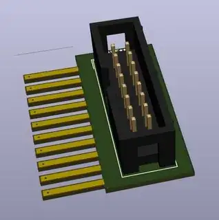

Your question is tagged "pcb design" - how about designing a PCB for it? :)
I mean a normal rigid PCB, with edge milled to shape to fit the connector pitch. Something like this:
Adapter PCB mockup
One end will mate with the screw connector, and on the other half you can put whatever connector suits your purpose.
For good contact, make sure to have copper on both sides of the "pins", use gold plating and select board thickness to be suitable for the screw connectors.
To avoid trouble with the PCB manufacturer, check what is their minimum "non-plated slot size". Usually it is about 1 mm. Put rounding arcs with equal or larger diameter on all corners to make it easy to manufacture.
