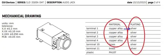

Update: after some more research I tend to believe that contacts themselves, the pieces of metal touching the plug, may not be coated with anything at all. These contacts may be bare nickel (as declared in datasheet), or "copper alloy" (which one?) or phosphor bronze, which all are seem resistive to corrosion and provide good contact. And all this gold and silver stuff is about "solderability" and units looking deluxe gems.

If you look closely at the datasheets, you'll find that the silver or gold plating applies to the pins, not the internal contacts.
From your silver plated jack:
The table in the upper right corner has pin numbers.
The low left drawing shows the pin locations.
The gold plated jack has a similar table and drawing.
It's not the contacts that are plated, just the pins you solder to.
Some of the pins are copper, others are brass. From what I've read, soldering directly to brass causes problems - the zinc in the brass dissolves during soldering, gets in the joint, and causes bad joints.
The brass pins must be plated to prevent the zinc from getting into the joint.
Silver apparently works fine by itself - plate a layer of silver and you are done.
Gold requires an "undercoat" of nickel - you have to do two plating steps with gold.
Silver is easier to manufacture, gold is better if your parts will be laying around unpackaged for a while - silver tarnishes, gold doesn't.
The silver parts even specify how long you are allowed to leave them unpackaged before reflow soldering. I expect part of the reason for that is the tarnishing.
The information above comes from this paper on diffusion barriers.
It appears that silver rapidly dissolves in solder with lead rather rapidly at normal soldering temperatures - to the point that SMD capacitors made with silver end caps are plated with nickel to keep the end caps from dissolving away entirely while soldering.
That implies that silver doesn't matter much to the conductivity in the final joint. You don't have a layer of silver between the copper pad and the copper alloy pin. There's pretty much just copper, lead solder, and copper alloy together and the silver is distributed through the solder.
The paper also describes the use of gold plating over brass. Both of the connectors have at least one brass pin.
The zinc in brass can apparently diffuse through the gold plating, and some of the copper follows. The oxidized zinc and copper don't solder well.
A layer of nickel under the gold keeps the zinc from diffusing. Zinc and copper stay where they belong. The solder joint is then between the copper pads on the board and the nickel layer - gold dissolves in solder like silver does, though not as fast.
Gold doesn't tarnish, so you don't have to worry about solderability as much.
Silver tarnishes, so you (in a factory setting) would have to pay more attention to storage than with gold.
In actual use, the silver goes away and you have a joint between copper and copper with solder in the joint. Gold goes away, but leaves a layer of nickel between the copper surfaces.
I don't think any of that matters if you are hand soldering small numbers.
The choice between silver or gold might matter if you are making boards by the thousands.
Why one manufacturer uses gold and the other silver may come down to having the facilities - or maybe those companies make products with both options.
In any case, it isn't about the conductivity if gold or silver or about tarnish that occurs after manufacturing.
It's all about chemical reactions before and during soldering.

  • Thank you for the info. From this I do the following conclusions and further questions: (1) contacts are made of "copper alloy" declared in the "material" column, and copper also tarnishes and subject to rust; (2) why silver-plated connectors cost comparable if gold require two platings, gold is more expensive and there's more space gold is applied to the gold-plated connectors than to silver-plated? – Anonymous Jan 12 '21 at 07:41
  • (3) copper alloy is expected to be reddish; why then picture of the connector has metallic parts white/grey? Nickel plating? According to the article @MarkoBuršič referred to Nickel is having enormous resistance, even tin plating is better, not mentioning gold. – Anonymous Jan 12 '21 at 07:46
