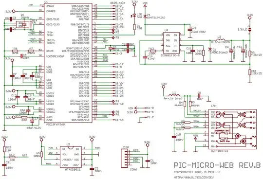

The Olimex PIC Micro Web board seems to support POE with a BD9001F switching regulator.
Olimex PIC Micro Web schematic
This looks like a low cost way of adding PoE to a device.

    Be careful -- this is not an actual PoE PD (powered device) -- it does not conform to the 802.3af spec and if you're using a 802.3af compliant PoE switch it will not supply voltage to this device. – akohlsmith Oct 20 '10 at 23:53
