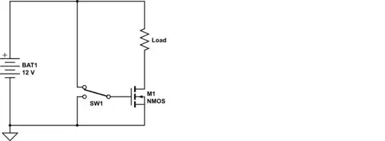

To switch a load where the ground is common using an NMOS, I would need:
Note how this circuit needs an extra battery to create a voltage that is higher than the voltage on the load. This is needed to apply a large \$V_{gs}\$ to the NMOS so that it will operate in linear mode and have a low on resistance (\$R_{DS,on}\$).
To implement that 5 V battery (5V is just an example), usually a voltage boost circuit is used like a bootstrap circuit or a chargepump. That's complicated! You'd need to have a good reason to insist on using an NMOS (there can be valid reasons but I will not go into that here).

If the common ground for the load is not a requirement then you can use an NMOS like so:
simulate this circuit
and then an NMOS is preferred (as with a PMOS, you'd have to make an extra low, negative) voltage). This can be a good solution if your load is a (string of) LEDs, a lightbulb or a motor. It is often a bad idea if your load is a circuit as then that circuit can have an unconnected ground when it is not powered. That can result in very tricky behavior and you really want to avoid that (to learn why, watch this video by Dave from the EEVBlog about powering a circuit through its signal pins due to ESD diodes).
