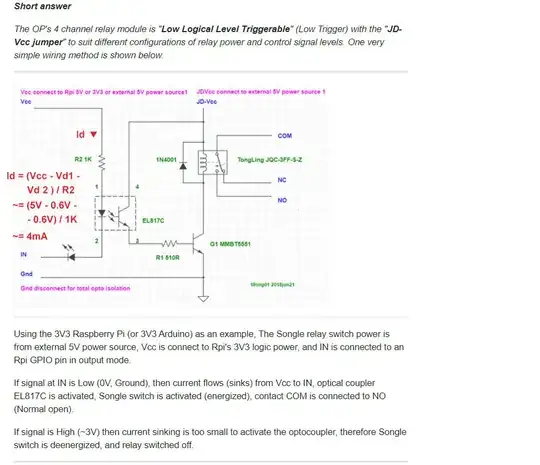

  1. To switch a relay
Appendix B show how an EL817C optocoupler is used to switch a relay. TLp582 can be use the same circuit to switch a relay. However, there is one complication: EL817C output is open collector, so it can only be used to sink current, or Low level triggered at the front end. On the other hand, TLP582's output is is Totem Pole (Push Pull) output, so can be used to do either High or Low level triggering.

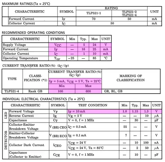

Appendix A - TLP582 Datsheet Summary
tlp582 summary 1
tlp582 summary 2
tlp582 summary 3
Appendix B - EL817C and EL354 Datasheet Summary
EL817c el354 summary
Appendix C -TLP521-4 Datasheet Summary
tlp521-4 summary 1
tlp521-4 summary 2
Appendix D - Switching a relay using EL817C
el817c example
