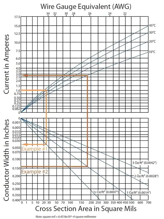

You can use this nomograph to determine the width according with current:
alt text
Using the nomograph
  1. Locate the width of the conductor on the left side of the bottom chart.
  2. Move right horizontally, until you intersect the line of the appropriate conductor thickness. Move down vertically to the bottom of the chart to determine the cross-sectional area of the conductor.
  3. Move up vertically, until you intersect the line of the appropriate allowable temperature rise. This is the increase in temperature of the current-carrying conductor. Conductor temperature should not exceed 105°C. For example, if the ambient temperature might reach 80°C, the temperature rise above ambient of the conductor should be less than 25°C (105°C - 80°C). In this case use the 20°C curve.
  4. Move left horizontally, to the left side if the chart to determine the maximum allowable current.
Reverse the order of these steps to calculate required conductor width for a given current.
More informations at this site: http://www.minco.com/products/flex.aspx?id=1124

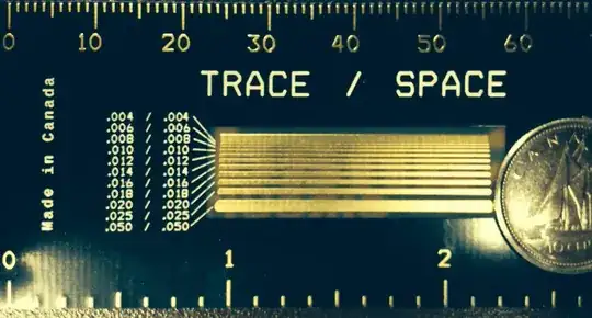

PCB makers sometimes produce swag that has this kind of thing on it, because it's common to want to get a feel for PCB traces that are out of one's comfort zone.
Here's a photo of one such trade-show give-away, with a dime for scale (as well as the ruler scales). Trace/space widths are in inches.

  • These also exist for SMT pads, through hole vias, and other things. Here is Dave Jones' version: https://pbs.twimg.com/media/BRcA7XjCQAEhO71.jpg – Greg d'Eon Feb 19 '15 at 21:32
  • Shouldn't the spaces between these traces be the same as the widths of the tracks? The traces look much wider that the spaces between them. – Chupo_cro Feb 05 '23 at 19:24
  • @Chupo_cro Looks like they only cared about the trace widths. You're supposed to imagine the space as being the same width as the trace. Wow, 8 years ago. – Spehro Pefhany Feb 05 '23 at 20:25
    I saw it's an old answer and thought you won't notice the comment but I posted it anyway and you answered in just an hour :-) – Chupo_cro Feb 06 '23 at 04:16

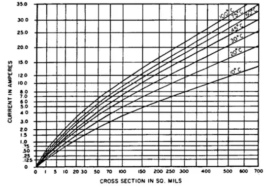

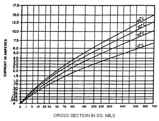

IPC standard 2221 "Generic Standard on Printed Board Design" (pdf, IPC web-site paid) (page 41) provides the following relationships between current carrying capacity and copper trace width:
enter image description here Figure 1: Cross section area to current. External layer.
Notes for the figure (also applicable for the Figure 2):
1) Temperature stands for temperature of the trace relative to ambient. That is, if, for instance, ambient temperature is 80C, 20C stands for 100C temperature of the trace.
2) The curves include a nominal 10% derating (on a current basis) to allow for normal variations in etching techniques, copper thickness, conductor width estimates and cross-sectional area.
3) Additional derating of 15% (current-wise) is suggested under the following conditions:
. a) for panel thickness of 0.8 mm or less,
. b) for conductor thickness of 108 um or thicker.
enter image description here Figure 2: Cross section area to current. Internal layer.

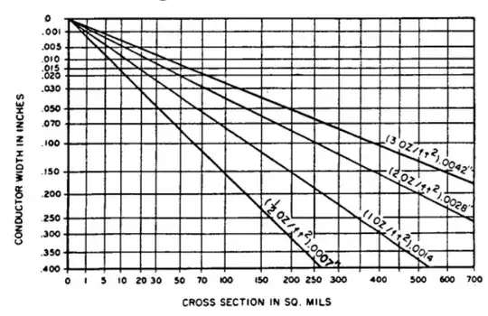

enter image description here Figure 3: Cross section area to trace width.
What is 1 oz copper?
The measure for the copper thickness on a printed circuit board. It's the resulting thickness (height) when 1 oz of copper is pressed flat and spread evenly over a one square foot area. It corresponds to copper thickness of 1.37 mils (34.79 um).
Explaining the relationship between cross section area and trace width (Figure 3)
1) Every curve corresponds to a particular copper thickness (trace height).
2) Area (horizontal axis) is calculated as product of trace width and thickness.
Below is a Matlab script with a calculation example. It shows that for 1 oz copper trace with the area of 9 sq. mils, trace width is 6.6 mils:
thickness=1.37E-3;%inches
area=9*(1E-3)^2;%square inches
width=(area/thickness)*(1/1E-3) %in mils
% result is 6.6 mils

1) Internal layer, current 400 mA, copper thickness 1 oz, ambient temperature 80C, trace temperature 100C. What is the appropriate trace width?
2) Look at Figure 2 (internal layer). Find the curve 20C (100C-80C). Find the point (9 sq. mils, 400 mA).
3) Look at Figure 3. Find the curve 1 oz. Find the point (9 sq. mils, 0.07 inches).
The answer is about 7 mils (0.007 inches).
