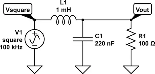

To illustrate my point, consider a buck converter as a square wave generator followed by an LC filter, followed by a load.
Here the square wave generator is "ideal". It sources or sinks current at any voltage, with 0 output impedance. There is no diode loss, etc. The frequency is 100kHz, and it the output is either 0-5 volts. Since it has a duty cycle of 50%. So it has a DC component of 2.5V. There is no feedback. Proper filtering should remove most of the AC leaving a steady 2.5V for the output.. According to the simulation it comes very close to that, except at start up, and a few "glitches".
Again, there is no feedback at this point.
Now, if we change the filter capacitor from 220nF to 2.2uF, we can see that the output is much less stable.
And, if we make the capacitor even larger, 22uF, we get this:
Adding capacitance decreases the square wave frequency ripple, but it makes the LC circuit more susceptible to longer term ringing at the LC resonant frequency.
Using feedback to adjust the duty cycle of the square wave may compensate for the tendency for the LC components to ring. But higher C creates a higher burden for the feedback loop.
As mentioned, this uses an ideal square wave generator. An actual buck converter does not have symmetrical characteristics at the high and low parts of its duty cycle. My experience, is that this compounds the problem of ringing, and one can get a sustained ring that never decays, even with a fixed duty cycle. In the 5V to 2.5 volt buck converter described, if the square wave generator is replaced by actual components like an FET and Schottky diode, the sustained ringing (never decays) may be as high as 100mV when using a fixed duty cycle.

  • The propensity of the filter to oscillate when a step is applied is determined by the damping factor. The inductor and cap have some ESR which add some slight damping. But it will still usually be underdamped. Your 220nF cap is not very realistic. 22uF is more like it. And your 1000uH inductor is also too big. 100uH and under would be more realistic although it depends on switching frequency. – user57037 Dec 30 '20 at 18:16
